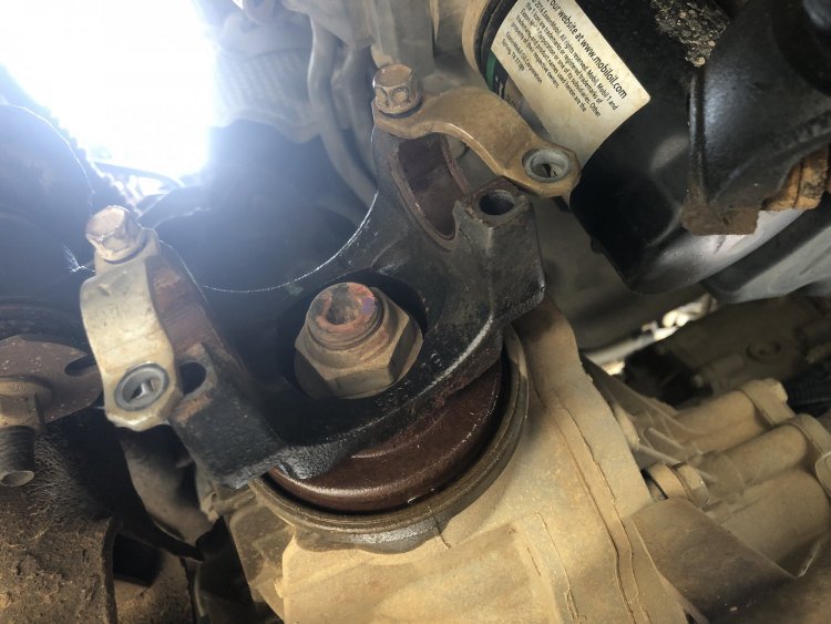

Alright, so I got the passenger side header on but I’m working on the driver side now and running into issues. I think if the yoke (not sure if that’s the correct word or not for this one but the thing in the picture) was out of the way it would help a lot. Is it as simple as removing that nut and taking it off or would more stuff come off and fluid come out? To specify I’m wanting to remove the black part that straps to the u joint.
Nevermind about the driveshaft stuff. I got them in from the top, had to move my onboard air compressor mount.
