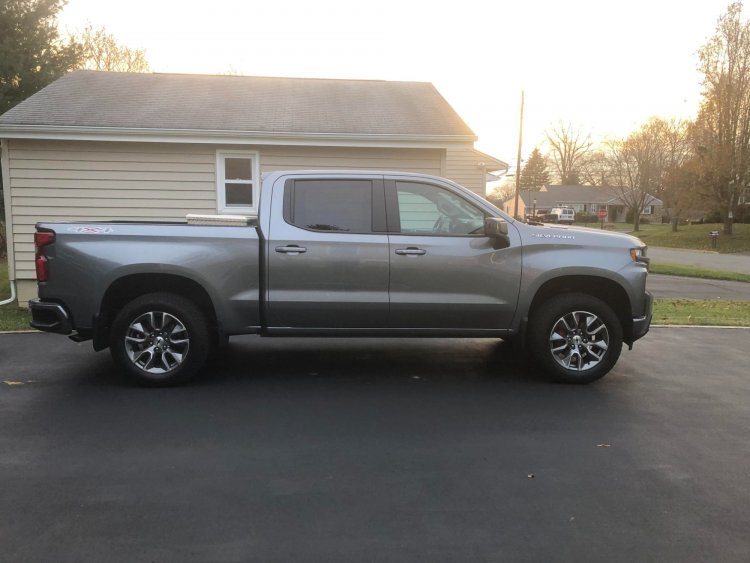

To all my haters, continue to hate just want to preface that 😂.  Anyway I am looking to get some leveling blocks as my truck is still nosediving.  I love the way the 3” blocks look but I have also read that the upper control arms tend to pop out with any blocks bigger than 2”. Does anyone have experience with that happening?  Also thinking about just taking out the rear blocks.  Or both. Any experience appreciated. Also does anyone know what this does about warranty?
If you have a trail boss or at4, you could take the rear blocks out to level and your truck will still be the same height as a leveled non tb/at4

I was thinking about doing 2” blocks up front plus taking rear ones out because i see so many “leveled” trucks still look nosedoving

Ok went with the Motofab 2" lift, Front( 1.5"spacer ) top strut spacer, front now approx 1 higher than the rear, wish I went with 1.5" lift.
Then I installed 1" Rear Lift Kit Blocks " U" bolts from Supreme Suspension, now truck is level + - 1/4" all around.

So that is 2” front spacers plus a 1” rear spacer?

Yes 100% correct, the spacers on top of front struts are not 2" but they raise the truck 2" and was a inch higher in front after, thats why I went and installed back space 1" now its all level plus/minus 1/4"
Dude just take the rear blocks out first. After you take the rear blocks out do some measurements. If you need to add fronts then add them but do the easy stuff first

Gotcha.  Do you recall how it looked when you had the 2” front spacers installed and back ones out?

You'll be doing the Carolina Squat and be nose high.
I added roughly 2 inches to my front and needed to add a spacer to the rear to get it closer to leveling out as the truck was obviously nose high.  I added a 1.5" block in the rear if I remember correctly, but I could be wrong as it might have been a 2", I just don't remember.
However, some models look like the front end is sagging from the factory and you can see the obvious camber on the front end so I'm not sure what's going on there.

Yes nose was high / thats why I added 1" blocks to rear. now its level plus/minus 1/4" as I posted earlier

After some investigation- my truck doesnt have rear blocks

    • Is it an optical illusion in the pic or is the truck really squatting that much horribly?
