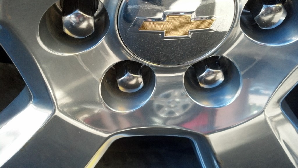

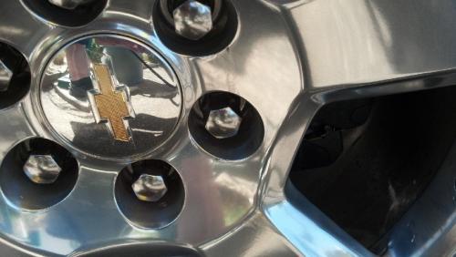

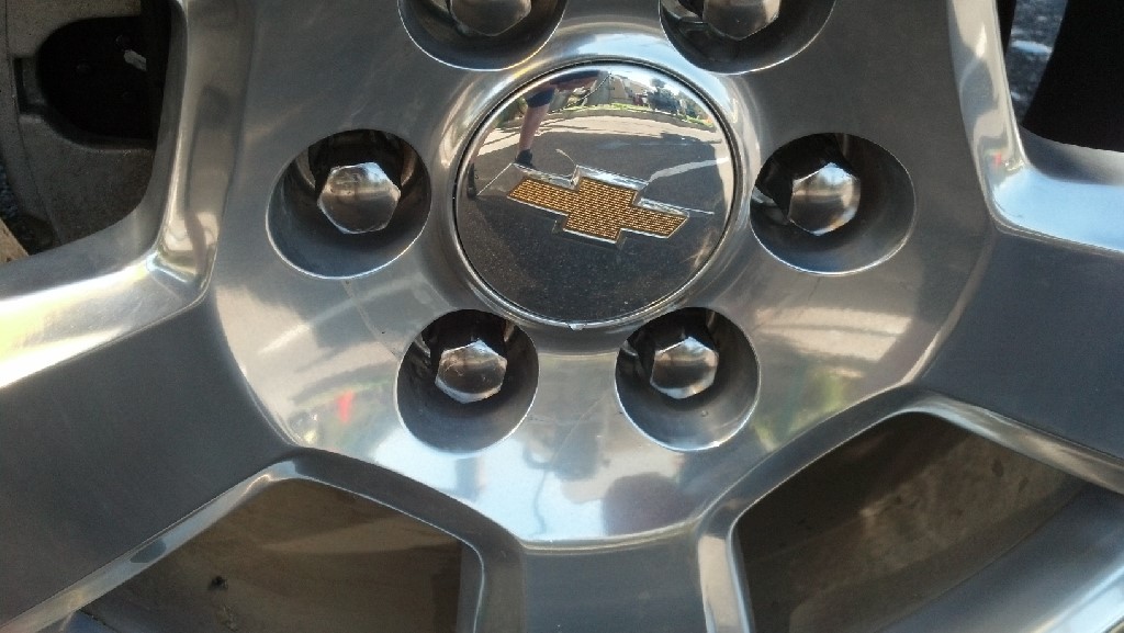

Pm26, sounds like you know a lot about the RF balancing machines, especially about how to mount the wheels on the machine.
This damage was done when the dealer put new Michelins on my 2014 Silverado, trying to fix the vibration.
What part of the machine could have done this damage? What, in your opinion, did they do wrong?

I do not know what their tire changing machine looks like and what clamping mechanism it uses. Some have internal clamps that clamp the rim on the inside, some have a rubber lined clamp that screws onto the central threaded shaft. The scratches shown could have been caused by tire changing machine if it used the latter clamping method . Also, these scratches could have been made by the balancing machine if they used an inner cone and outer pressure cup without the non-marring rubber ring or damaged rubber ring. Unfortunately, when these items wear out, many shops do not replace them and use them until they are so worn that they start scratching rims and cause other damage. Pressure cup non marring rubber rings do wear out with use and need to be periodically replaced.
The photos in the link should give you an idea. Read the TIP under second photo in the"how to mount the wheel to the balancer" section. I think that a badly damaged pressure cup did the damage to your rims. Perhaps the scratches are not that deep and can be buffed out? I know that those rims cost a lot of money and therefore they should be handled with proper equipment and care.

The scuffs are from the clamping cup with no rubber or damaged rubber, and you should get it back to the dealer so they can get you new rims.
