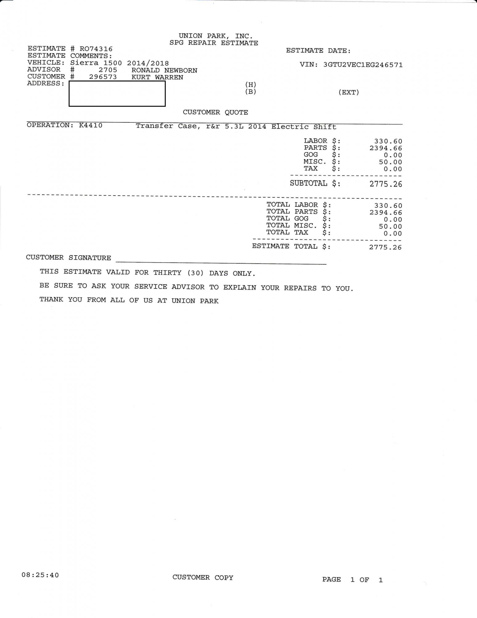

Truck dropped off at Union Park GMC and they have stated that the Transmission is Shot and there is "shavings" in the transfer case and it should also be replaced. So i want to reach out to see how many others have had the transmission fail within 100,000 miles that do not tow with there truck!
attached is the Price you would incur if this is a common issue that GM does not fix there Quality issues.
give a shout out so i can be sure this is just a odd case and not a common occurrence since the bill to repair this truck is exceeding $6,000 as shown in the attached repair orders, i bought this truck to tow a small camper and haven't even bought the camper yet and the transmission failed on a 300 mile trip. this truck is clean and never been off road.

The repair is only as smart as the tech that performed it!!. seems After the transmission burnt its self up (they claimed TCC failed) No Chit from heat ya think !! they replaced the transmission and there diagnosis of the transfer case shavings were (Normal Wear),  now we are here (3) months later and the Tranny temp read 225 deg yesterday not towing anything.. so i checked the transmission cooling lines and they are cold, well up on the lift let it cool down and removed the Transmission thermal bypass valve and sure enough it was sticking. i cycled the plunger a few times put the unit back together and drove all over hell and it was now working properly (temp runs at 194- heats up to 202 max then back to 194) so i called my local dealer in MA and ordered the unit $85)  what truly pissed me off is this is a new transmission and likely the cause of replacing the old, do you think they would have replaced this!!! When i dissembled this unit there was oxidation all over the top around the C-Clip. this was the original OEM Thermal bypass valve) it was never replaced!!  since the transmission is now under 50K warrenty i could have left it up to GM and maybe next transmission they would have caught it, but i just decided that the $85 part was just easier then the BS.
