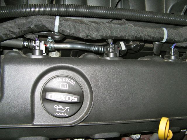

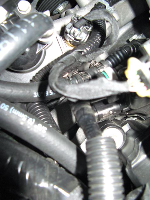

I hope these pictures help. It was hard to get good clear photos. I removed the original GM connecting part and cut out the middle section. I left about one inch of the hard tube at the curved (front) end and about four inches of the hard tube at the other end, and disposed of the middle piece.
The instructions said to heat the end of the hard tube with very hot water, and then slide it on the included nipple. This didn't work for me so I bought a piece of 5/16" hose just like the included 3/8" hose, and slide one end of a short piece on the hard tube and the other end on the nipple. The 3/8" hose goes to the other end of the nipple and runs to the Moroso. I added clamps, but they probably were not necessary because it was a very tight fit.
The Moroso does not have a flow direction, so it doesn't matter which side of the Moroso you hook it to. When you are finished you will have one hose running from the front to one side of the Moroso and the other hose running from the drivers side to the other side of the Moroso.
This shows the drivers side about half way back.
This shows the front just below the throttle body. It runs horizontally in the center of the photo and has two clamps visible.

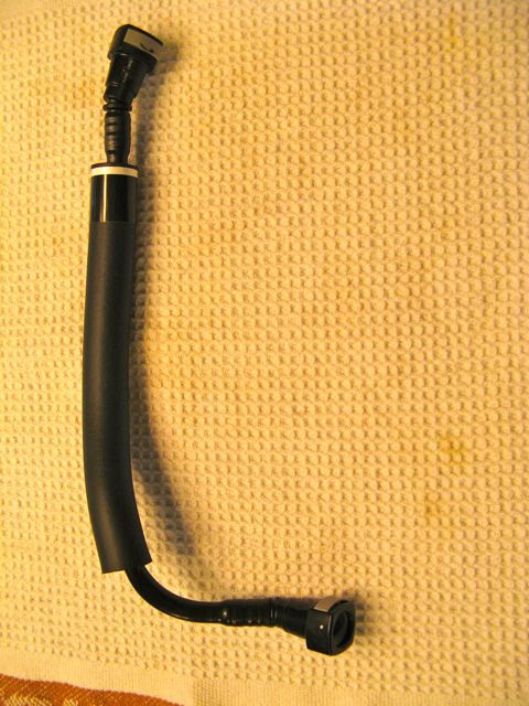

This is the original GM part that connects the front to the side. The curved end goes to the front. Be careful when you detach this. Fully depress the light colored protruding piece and slide it off. There is one at each end. When you reconnect it, just slide it on and you will hear it click into place.
