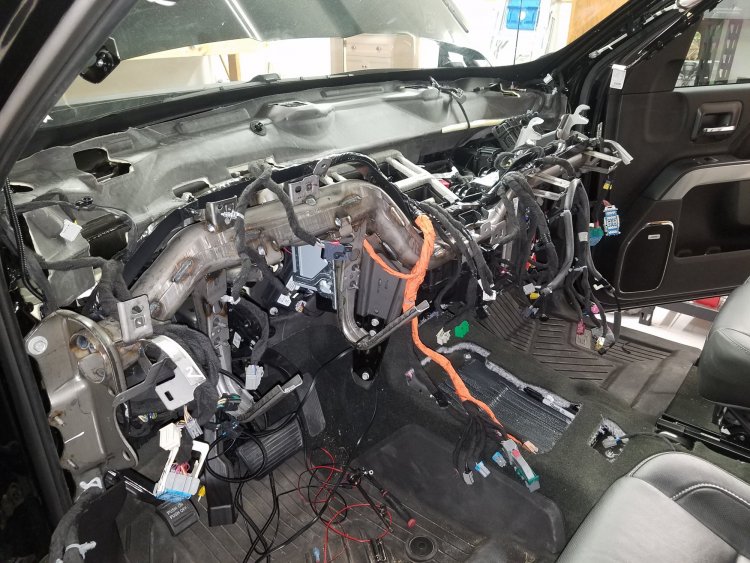

For the factory HDMI, I think that will highly depends on the year of your vehicle.  If you're a 2017+, it's doable as it'll just take some time and money.  If you're 2016 or older, it's easier to splice into the auxiliary input like I did as I believe there's software issues since earlier vehicles didn't ever come with it.  It'd be best to ask WAMS or someone like them to find out for sure on the programming if you're wanting it for a 2016 or older vehicle.  I already had all the hardware by the time I found out GM added an HDMI so I never looked real deep into it.
31 minutes ago, PAPER said:
I purchased the factory center console harness & rear HDMI part , Hopefully that will help make things a little easier
If you have that, just buy the corresponding dash harness for RSE and the corresponding options your truck has and the RSE roof harness.  Then you'll just need the Blu-ray/DVD drive, both screens, and a programmed HMI.  To get my rear inputs, that is what I ended up doing but your dash will need pulled and your headliner dropped.  It's not hard, just a little time.
