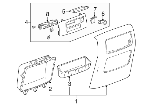

I also can’t find any info regarding 22894643 that it contains controls. When I eBay it; it shows when the price much higher even it does contain controls.

With the part in question, 22894643, when looking at the film in the parts catalog and you see a box around numerous pieces, it means everything is included that is inside the box with that particular part (#4 in the second picture in the screenshot).  They SHOULD all come together though this is not 100% correct which I have experienced first hand but everything was included when I purchased this part and this is correct MOST of the time.  I personally don't purchase much parts online, especially when I am "exploring" to modify my vehicle, especially if things are not certain in the film as the dealers will always have the most up-to-date information.  If you run into an issue based on a discrepancy according to the film, the dealer has always made it right with me at least, because their resource from the manufacturer was incorrect.  Any good dealership should do this in my opinion.
