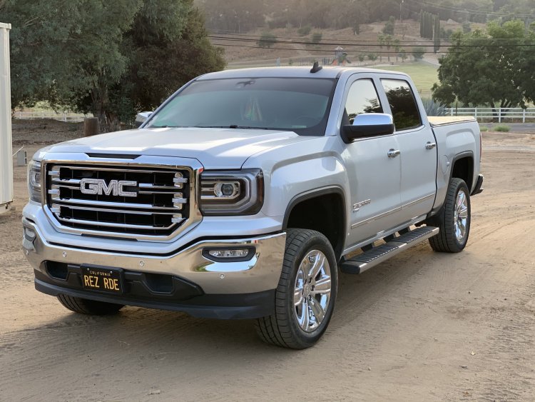

Factory 20s with 275/65r20 BFG KO2 tires.  It has a 2” Rough Country leveling kit

16 minutes ago, TXGREEK said:
And you have no rub at all on a full turn lock?
None at all!  We are going to be putting some BORA spacers on it soon to get a aggressive stance.  These wheels have pockets, so we can run the 1” spacers without issues
That’s literally impossible, you’d have the “ONLY” truck on this forum with the exact setup that doesn’t rub. I put same level on mine with same size tires and got rubbing at full lock, neighbor same, everyone on here the same. You must have a magical truck

Haha don’t know about magical, these tires are pretty narrow.  Also they have about 10k miles on them, maybe that has something to do with it.  They came off of his 3/4 ton Denali when he traded it in

Your father, being it’s your fathers truck and drives it daily does get a rub on full lock, just doesn’t advertise it. Another guy on here denied it for the longest time until he realized his misinformation was costing desperate people a lot extra that wanted bigger tires and then realized they shouldn’t have listened. Unfortunately, very few people on here admit they messed up. Being that it’s an 18, spacers will void your warranty on anything attributed by their installation, dealers HATE Spacers! They cause added stress to your suspension, especially your bearings. Good luck and God Bless

Haha I’ve driven my dads 16’ truck plenty man, and can tell you for a fact that I don’t get any rub at all when I drive it.  On my personal 17’ truck I ran the factory wheels with a 305/55, and it rubbed on the control arms like crazy.  The 275/65 is a skinny tire, idk how y’all are getting rub with it.
Also I’m not worried about running BORA adaptors, they’re high quality, and the worst they can do is screw up a hub bearing.  But so can wider low off set wheels.  It’s part of the game man.

I’ve seen much worse then hub bearings go out, dealers will even attempt to deny premature brake issues, shocks, etc. dealerships will deny practically anything associated with something attached to the truck like a spacer but Bora is the best of the bunch. Ok, Be safe
