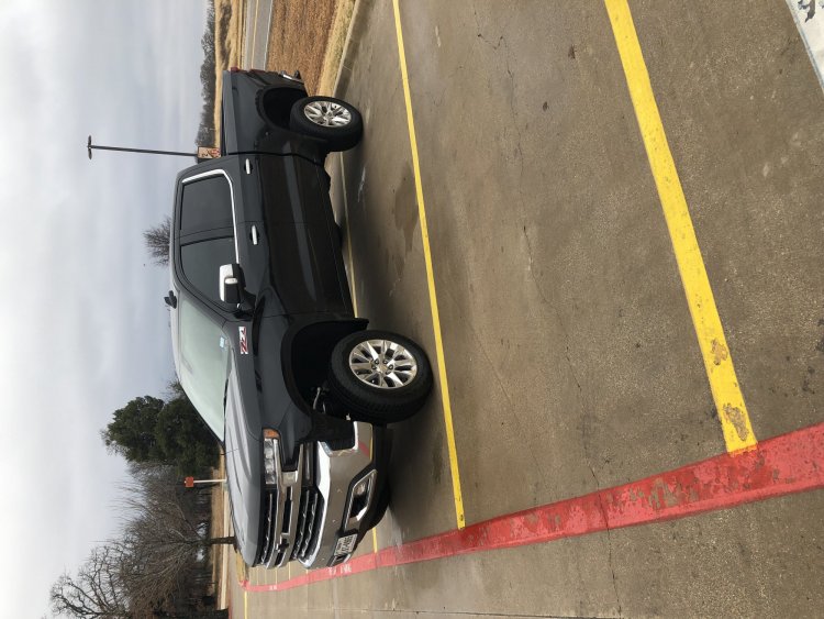

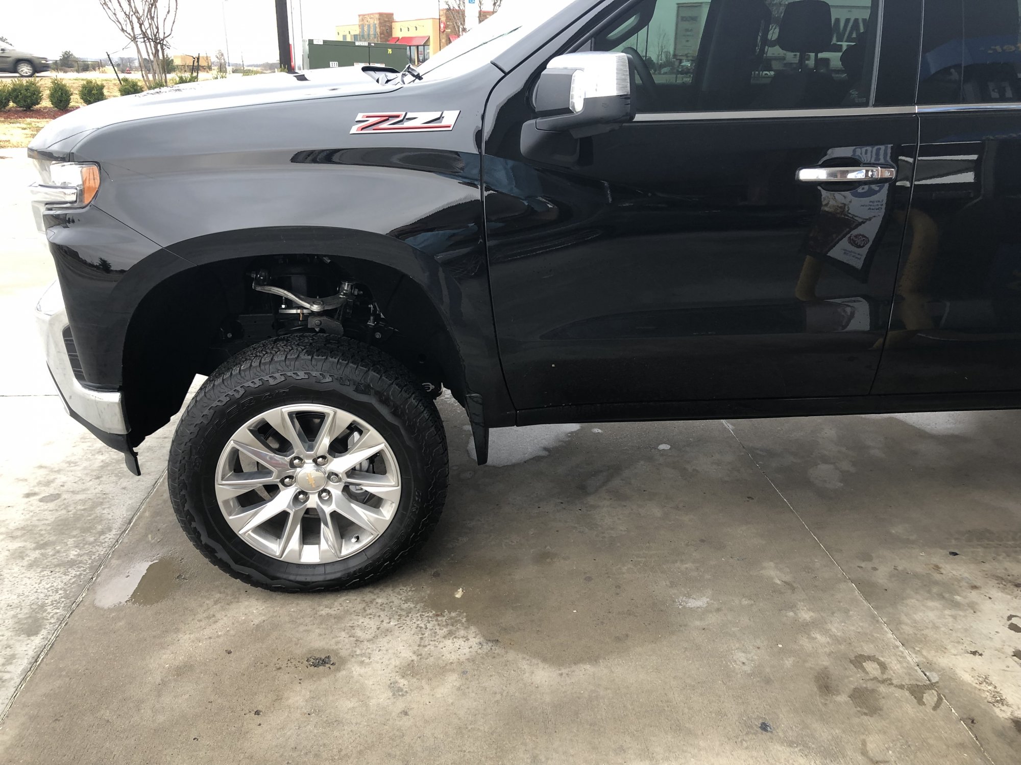

Ok y’all are going to make me go first......
nice teaser! more pics please! :)
4 hours ago, Big E in TX said:
FYI, being the guinea pig SUCKS!
running into install issues???
