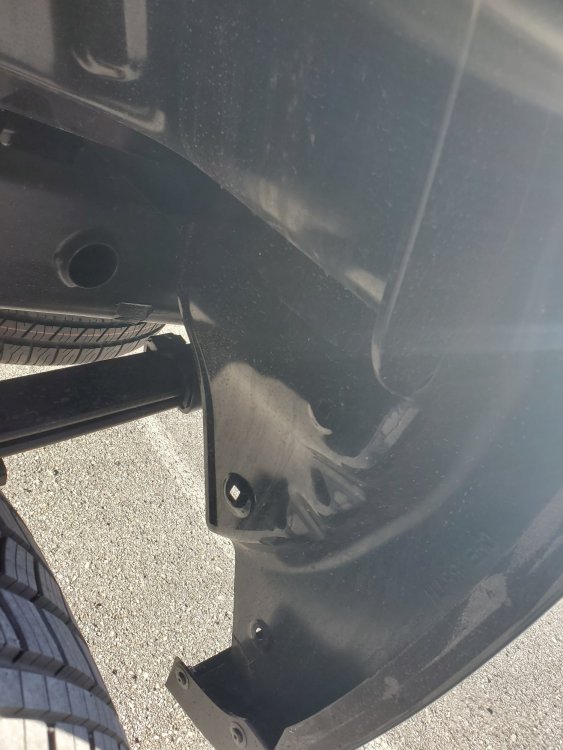

Just got a 2020 Silverado, and yes it has no rear inner fender liners.  The sales person told me Chevy pulled them due to rust issues(not sure I believe this).  The painted surface in the fender
well will be Swiss cheese in weeks.  Any suggestions?  What about spay-on liner?
They pulled them to make more money!  They are now optional. More rocks, salt and debris to wear the paint away in the wheel well will make it rust faster and sell more trucks. Get them protected. I took my truck apart the first week I had it. Fender liners, door pads, fenders and used a waxed based rust proofing everywhere inside the rockers, fenders, hood, doors, bed, bumpers and rubber rust proofing behind the fender liners to prevent any rubbing for debris.   I probably went overboard. But I plan to keep it awhile.
I finally got the service and sales managers.  You are right these are optional.   They agreed to order the liners for me.  This is beyond stupid.  I definitely will be cleaning that area before they install them.
