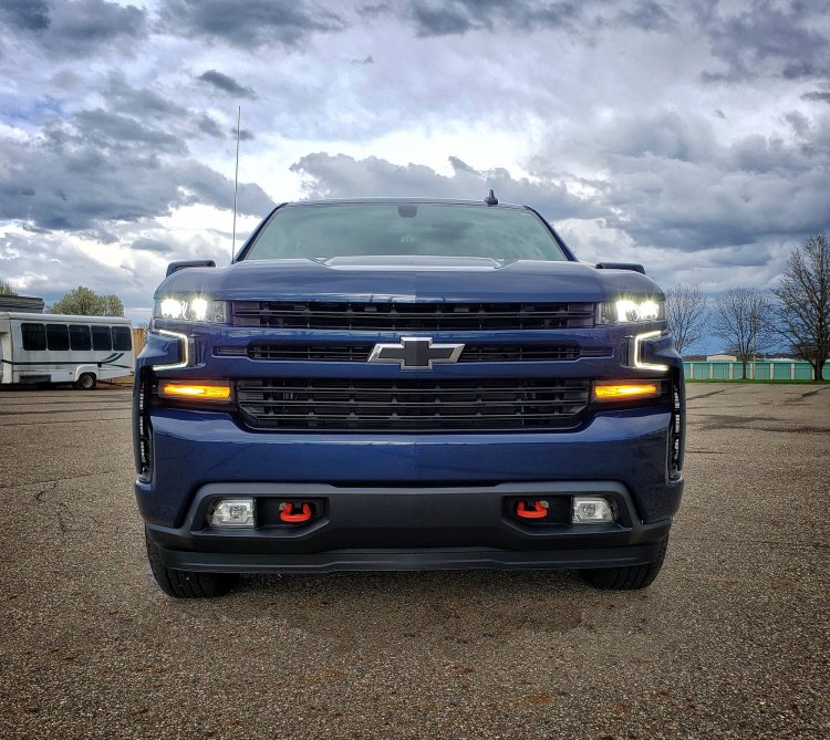

Can you post a picture of what they look like now?
2 minutes ago, andychabot said:
Sure, here's the front end with the LED's in the turn signals.
Thanks, looks good!
