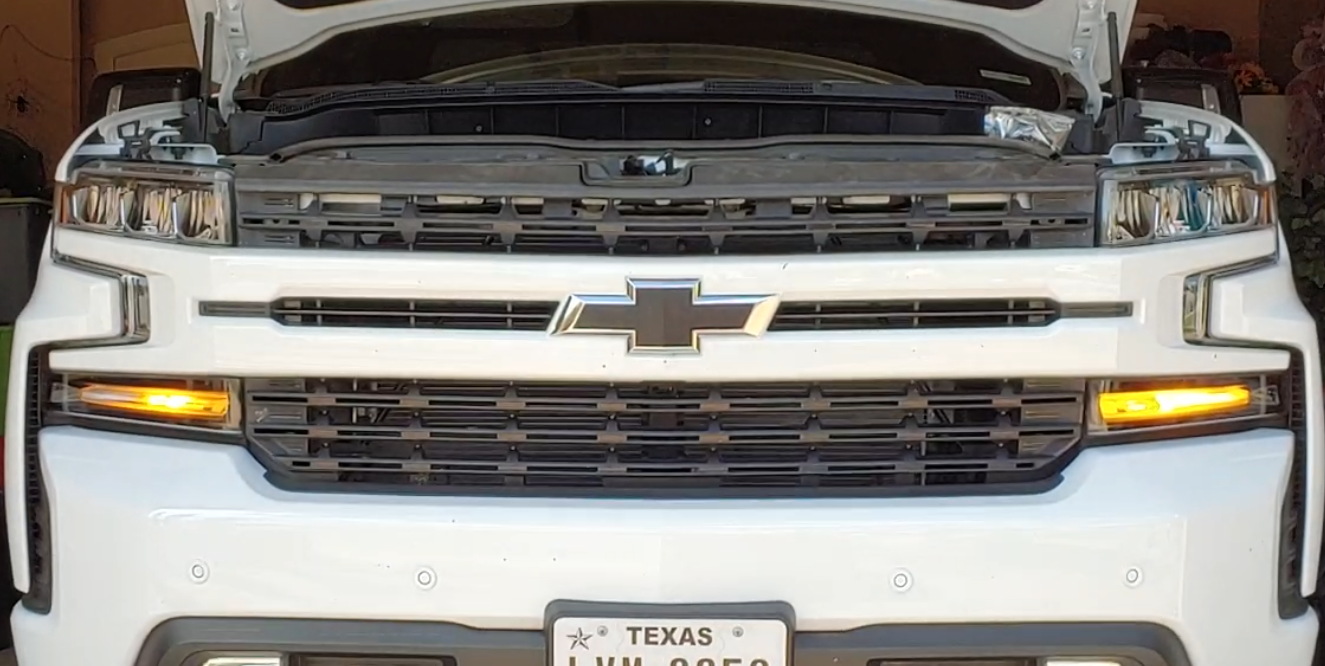

Just installed these in the turn signals of my LTZ.    Looks much better and brighter than regular bulbs.   As stated so per easy to change.
Just installed the Amazon ones recommended. Much better. Left is the original halogen, right is the LED. I'm sure it looks much better at night too.

On 4/9/2019 at 6:52 PM, Andy Chabot said:
I ordered a pair of amber LED's for the front turn signals and they came today. They are much brighter than the bulbs, better color and no hyper flash or codes...
Why GM didn't go this route with the RST is beyond me... A major upgrade...

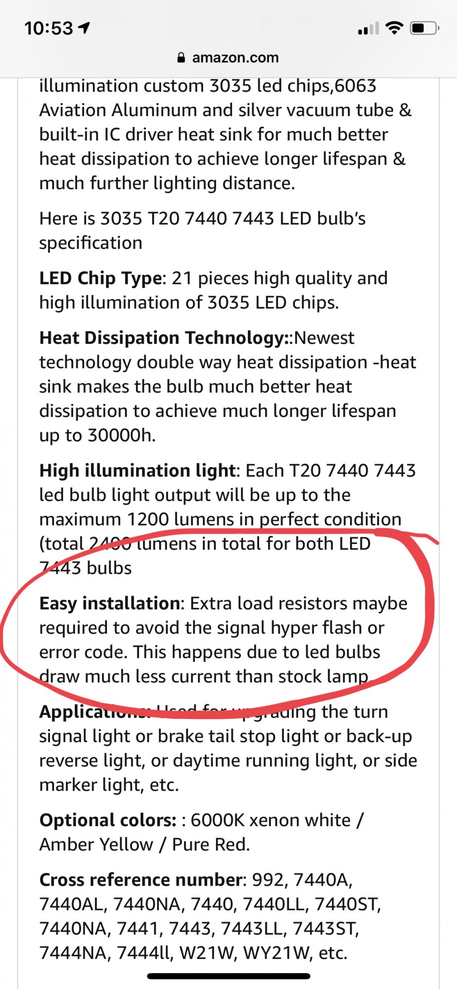

I bought these, but they hyperflash on me:
ANTLINE Extremely Bright 7443... https://www.amazon.com/dp/B07P9T7D1W?ref=ppx_pop_mob_ap_share

I’m skeptical they will work for you, after reading this in the item description. This is basically what mine said, too.
I’m wondering if the lights with many more diodes on them keep it from hyper flashing, as they use more juice?
Agreed.  They all say that in the description unless they have built in resistors.  I’m banking on the fewer diode part as well.  I’ve now changed low beam, high beam, reverse and license plate to LED with no problems.  I will spend the money to find a good alternative for the turn signals.  Should have these by installed by early next week or sooner.
