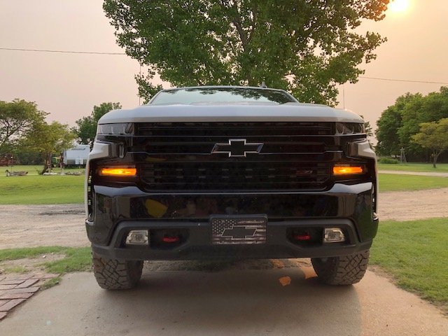

Shout out to JR09country. The LED bulbs he recommended have built-in resistors and work great. No hyper flash. ????
For how long have you had the bulbs? Can you share the link?
Ive had them on for about 3 weeks and have about 200 or so miles on them. I dont drive a lot so hopefully they keep on working.
