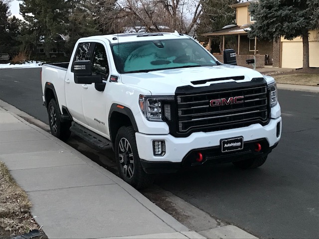

Just took delivery Saturday of my 3500 AT4. I was actually working on the Silverado, between a High Country in a color I didn't really want (brown) and a non-high country also in white, which oddly had a white interior roof panel which I really didn't like either. The dealer pulled some crap about my old truck, so I left, thought about it overnight, and went to the GMC dealer on Saturday morning for this truck. It had literally every option I was looking for (dual alternators, trailer tire monitoring, trailer wiring provisions, upfitter switches, sunroof, head-up,  of course the AT4!) so I worked for a while and got a good enough deal. The Denali would have been less, but I wanted the AT4, so I did it.
Color wise, both the blacks are fantastic, but we offroad a lot when we're not towing, and I thought it would never look clean. I had a vehicle in the early 80s that was near the same bluish color as the Grey Metallic, so I didn't want to repeat that. The dealer had a red one in stock, and I actually went to buy that one, but I liked the white better in person. The dark blue is fantastic and so is the medium grey, but I couldn't find either with the options I wanted near Denver. Plus I already have two other vehicles that are silver and dark silver, so I guess this one completes the fleet.
So far I just love it. So far meaning about 100 miles :)
I've got to get my camper installed this weekend, which means finding the Trailer Wiring Provisions under the bed, drilling a hole and mounting the socket. I also have to remove the tailgate, and I'm planning on retaining the cameras and the puddle light and moving them to the back of my camper. Bonus points if I can find a way to move the roof-mounted rear camera for the mirror and put it on my camper - if not I'll just buy the trailer camera and put it up there.
