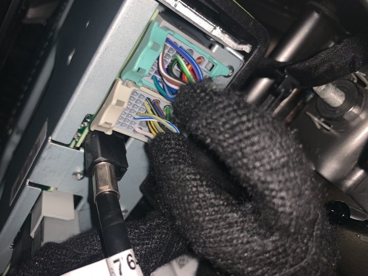

Does anyone know if there are aftermarket general harnesses or loop harnesses that plug between the back of the infotainment system and the body harness?  I want to be able to take the audio signal from each of the speakers, send it to the rear of the truck into a DSP and amp, and then back to the body harness and into the speakers.  I don't want to cut factory wiring.  I've checked Crutchfield and a little bit online but i don't seem to see anything for 2020.

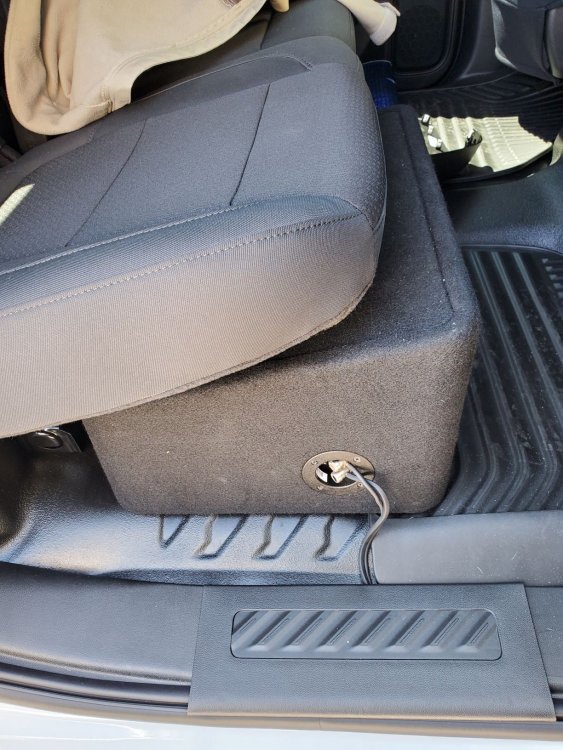

I replaced the front dash and door speakers with a Kenwood set KFC-XP6903C.  They sound great and I don't really think it needs an amp for my use....gets loud enough without distortion.  The dash speakers were a direct bolt in (I clipped the plug off the stock speakers and re-wired into the Kenwood leads) and the 6x9 was bolt in after you snip the bracket down to fit the Chevy.  I had a 10" solobaric in a box that I transferred from my 4 runner that fits perfectly under the rear seat.  Running that with a 200W per channel amp...again, more than enough for me.  I used an LC2i to convert the rear door speaker signal to RCA and add the bass frequencies back.  The LC2i lets you bring back the bass that the stock system cuts out...quite a few you tube videos on it.  Amp and LC2i are under the passenger seat, just took the entire seat out to make it easier.  Wasn't too bad...took a bit of time to make sure it was all right and tidy.  I also used a marine battery switch to use as a disconnect from my battery to my amp and lights.
The set he sells in the link I posted is two plugs with wire that basically intercepts the stock signal to send to an amp, and then sends the amp signal back to the speakers.  I'm not a super audio snob, but I like it to sound good, and just the Kenwood speakers makes a huge difference in the quality of sound.  The bass fills in the low end details.  I'll relate any further details as I did them if you want.

Also, how tight is the Kicker fit under the seats?  If I go full bore I will need to figure out how to get everything under the rear seat - unless there is someway to get behind the rear seats, i tried to find a way to release the upper seat backs on the dealer lot but couldn't seem to find a way to do it.
My bad...3 1/2.  I remember seeing something that the seat back wasn't meant to be removed...i.e. very hard to get to everything.  I'll take a pic of the sub under the seat.
