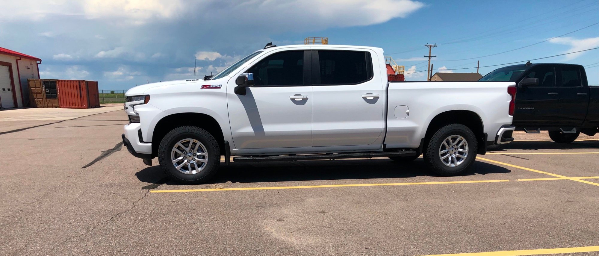

Nothing on the tires but I did get them installed today and love it so far. We went with the 1.5 or #4 slot and it's sitting pretty nice I think... now what lol
Looks good! Amazing what an 1" - 2" will do for looks. Any noticeable improvement in ride yet?
The truck is just firm enough and feels glued to the road so to speak. I had the standard bilsteins on my old 2002 and they where great also.
Might have to look at some new tire options next...  The truck drives so much better now!!

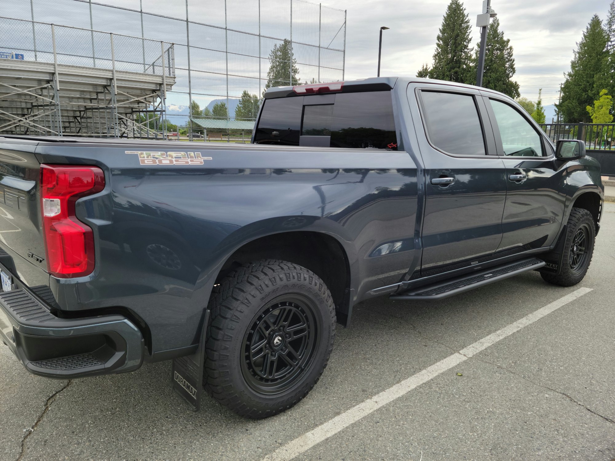

2021 Silverado RST Duramax to Trail Boss build.....
On 6/4/2021 at 11:10 AM, OctavianCDA said:
I have bilstein 5100 all around.
Front 2 inch lift position.
Rear I added a Rancho 1.5 inch lift kit that came with blocks, u-bolts and bump stops extenders.
Trail boss stickers on a non-trail boss? :wtf:
