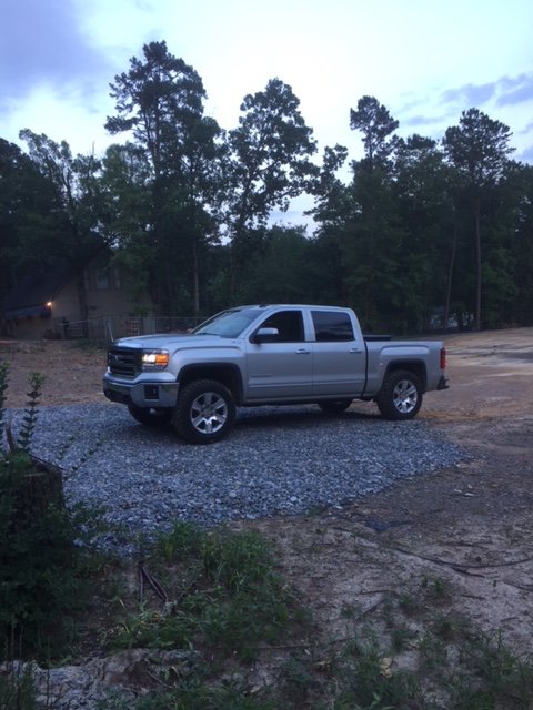

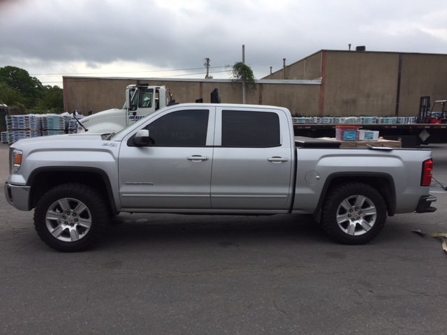

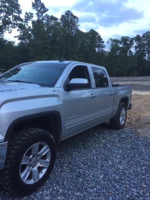

Haven't been on in a while. Just wanted to clarify for those who want my setup that I NEVER cut the bump stops and I drive offroad and at full flex regularly and have never had any issue at all. Everything is in perfect condition besides the struts are a little rusty on the treads from driving in the salt on mountain roads. I have 45,000 miles on the shocks and I love them.  First pic is loaded down with a half pallet or more of shingles (about 2,000 lbs +) Last pic is most accurate of what it looks like. Sits perfectly level, never have made time to put any blocks or airbags on the rear but I pull 8-10,000 lb trailers regularly and it sits much better than when you have a pallet of shingles. Of course most of y'all would know what its like to have anything in the back of your truck anyway :loser:IMG_4361.JPG.715bff2f617849c6355916cf15ce871b.JPG
IMG_4519.JPG.58e33332e68d5d3406cbe9d8c9ba5d59.JPGIMG_4519.JPG.58e33332e68d5d3406cbe9d8c9ba5d59.JPG
Trucks look good. Are you going to add a add leaf kit or blocks to add height in the back?
I need to as much as I haul stuff. I just haven't had time to work on it. When I get off work I have enough stuff to do around the house as it is. I would like to add a leaf or do airbags probably soon hopefully.
Definitely looks much taller in the front than the rear.
Air bags don't add a lift in the rear unless you pump them up, then the ride is HORRIBLE without a load (I run mine at 5psi when unloaded).   Add a Leaf is also going to stiffen up your ride.  I'd go with the taller rear block.
