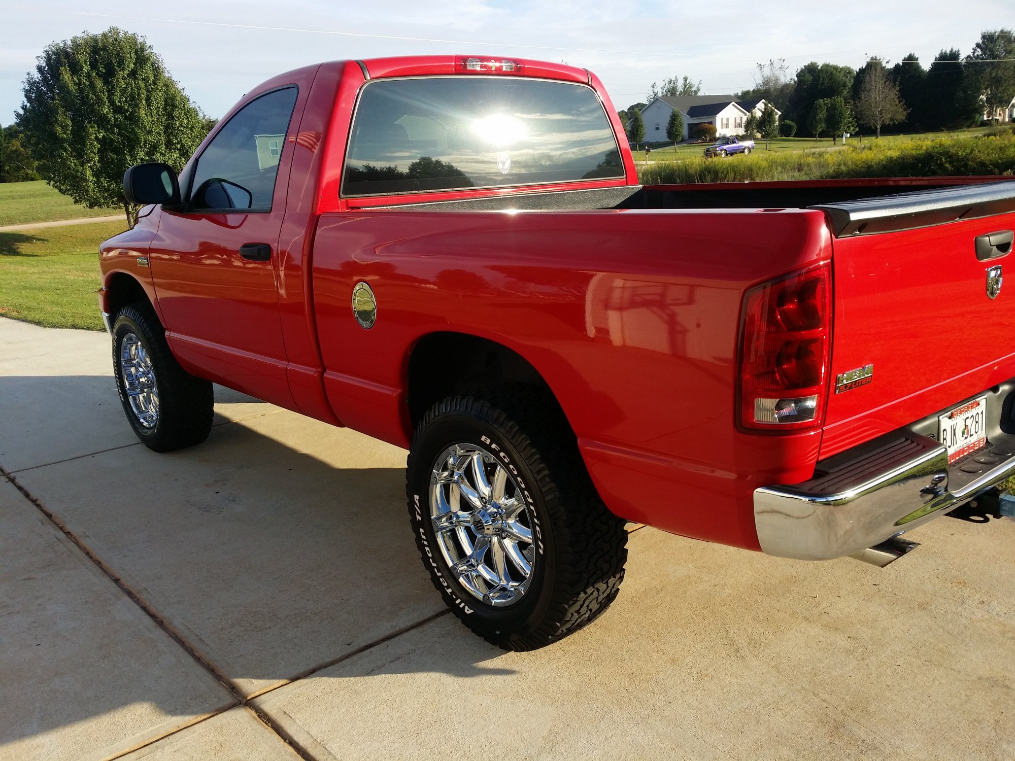

Id like to downsize to 20" wheels with 285/65R20 BFG KO2's. I had a previous truck with those and really liked the look and ride. Gotta sell these 22's first and then will try it. If BFG made 22's then id keep my stock wheels. I dont care for Nitto's.
Id like to downsize to 20" wheels with 285/65R20 BFG KO2's. I had a previous truck with those and really liked the look and ride. Gotta sell these 22's first and then will try it. If BFG made 22's then id keep my stock wheels. I dont care for Nitto's. 5b280db00b83d_Truck5.thumb.jpg.ed4eadc8efcaedc0a454c46e28146ba0.jpg
