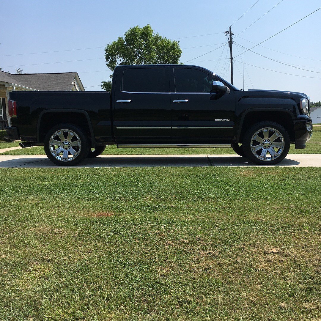

I just installed a Suspension Maxx 2.5" leveling kit on my Denali FOR Magneride and nothing rubs. I have the stock 22" wheels and tires. Don't worry about the upper control arms rubbing on your stock setup.
Looks good, I leveled first then put on 275/60’s versus 55’s making it 33’s”

I've got an '18 with the same size wheels and a 2.25" ReadyLift level and no rubbing what so ever.
i have the same wheels. do you think a 285/50-22 will clear the control arm?
do you have pics? did you do the new control arm kit? what about the Magnaride? they say there kit just needs a dealer recalibration.
