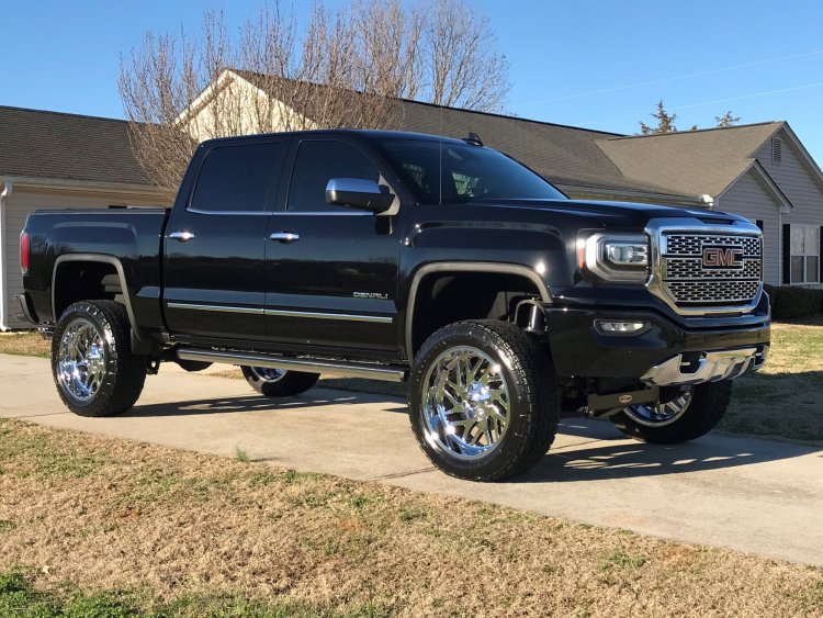

I did end up getting a 4" lift from ProComp. Much better kit. It was more expensive but worth it. The 4" from Fabtech was really only about 3" lift at most. Pretty disappointing and after it settled it was no higher than my level kit. The ProComp kit is very nice and after measurements and settle it sits 4.1 inches higher than stock. Rides great

Hi, I’m looking into a 4” lift for my Denali and having tough time deciding. Did you say you tried the Fabtech first then had the ProComp installed after? If so how did the ride change compared to stock.
You have photos?

The Fabtech was not for me. It barely lifted it over the leveling kit I had on. The ProComp was a true 4” lift. I can’t tell any difference over factory. Rides great with the Magneride
Very nice build. Looks like you even tire shined the treads. Did you end up putting a blower on your truck, I am more curious about that.
