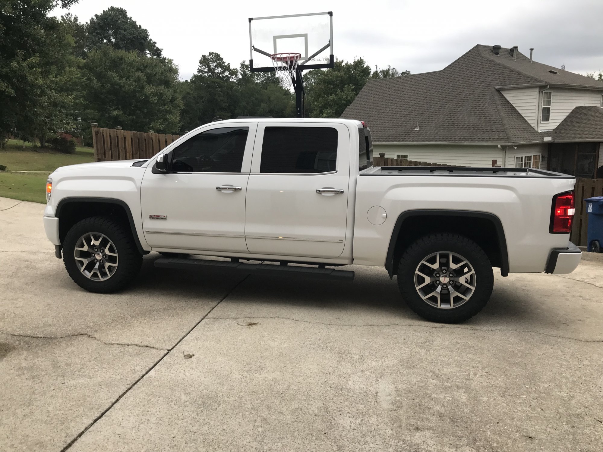

Here is a pic of mine after the install.  I’m running 295/60r20 in ridge grapplers, which run wider than other brands.  I get a little rubbing on the liner, which I pulled back, and a little on the sway bar. Overall I’m very happy with the eibach setup. I have a tiny amount of rake, and the ride is much better imho.
