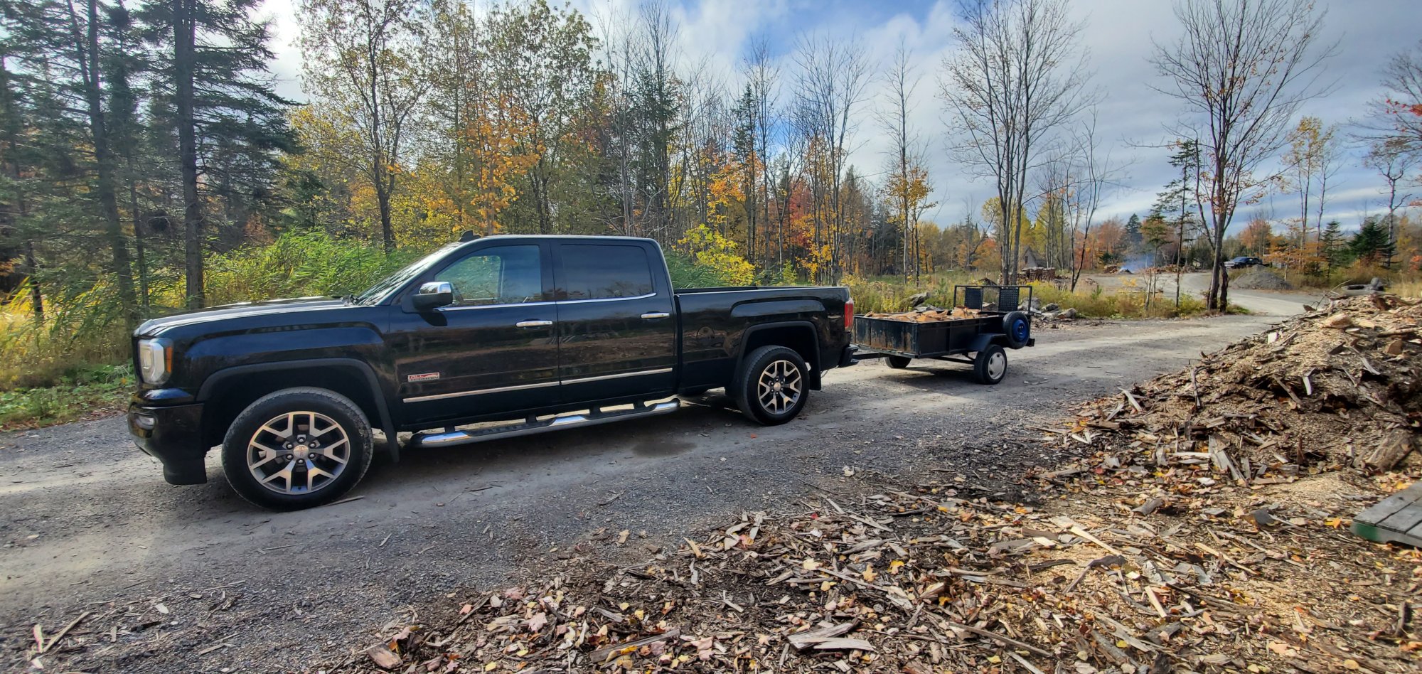

finally getting my springs and struts installed tomorrow. Wanted to clear some things up in case it wasn't clear after talking with Eibach. I had a bit of a hard time understanding the grooves and what lift they provided.
If you have the Eibach springs with the lift shocks the lowest setting is 2.5" with the next setting being 3.2" and the next 2 way to much for this application.
If you have just the shocks then those grooves and increments change. If you are confused I highly recommend calling Eibach. They were very helpful as was @Waterfowler41 install video. Just needed some clarity on the grooves.
I've had RC spacers on the truck since I got it new so the Ranchos are shot at 60k miles and am looking forward to a ride quality increase. Will report back with pictures and a review.
Have had the kit on (springs and shocks set at 2.5") for about a week and the I give this kit an A+. It could be because my Ranchos were shot, but the truck is night and day and I couldn't be happier.
Only negative to the kit is the truck doesn't sit quite as high set at the 2.5" as the RC 2.5" spacer kit did. I am not too bummed though because the ride quality has improved sooo much. I forgot to take measurements before to see how much it dropped it but it is only a tad.

Looks great@techsan15 !
Thanks man! Appreciate you posting all the info. This kit isn't widely used and needs to be. Great price and much higher quality than a spacer level.
