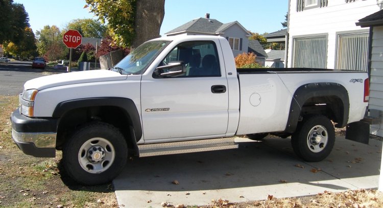

5bc63bd69580d_ChevyPickup003sm.thumb.jpg.994be33dc68728adf9e36d0e97f3cd9c.jpgThank you,
It fit reasonably well. 50 foot beautiful... [emoji4]
Yeah the body lines are the issue. But it’s better than nothing. I need to replace my bed due to some minor rust. But I’m having issues finding a nice black short bed
