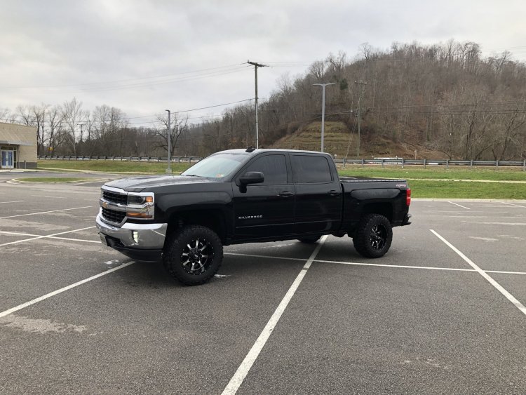

Hey all
I recently went to some 18x12  -24 moto metals with mt Baja Mtz tires and they are measuring out at around 32” from my stock wheels with 265s on my 2016 5.3 6sp cc 3.42gear
Mpg went from 21 to 13 avg
trans temp up from 188 to 194 constant on highway
power feels like my old 4.8 now
I got a hypertech 2.0 tuner but no help really
I expected possibly a loss of 2-3mpg but this is a little much
I had planned to go 6” with 35s but there’s no way now unless these Mickey Thompson’s are causing way to much rolling resistance has anyone else had this big of a lose with mud tires or offset rims ?

No Baja MTZ tire is approved for a 12" width on an 18 inch wheel.  I was looking up the cause as folks here have posted the solution and came across that tidbit of information.  Your new tires and wheels appear to be about double in weight to the originals.
you just added a bunch of excess weight thats probably sucking 20hp off the motor.

They are quite near double the weight of stock wheel combo but nearly identical height now that they are worn same as a new 265 tire
