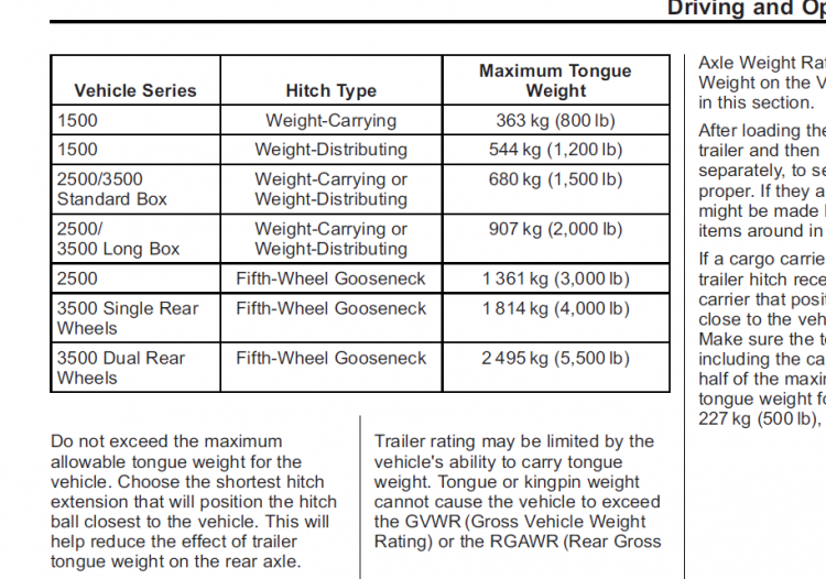

The OP has it right. His setup is taking too much weight off the truck. The trailer is rocking up and back and causing the bounce. They're not meant to take all the weight off the hitch. Here is a copy of the chart from the owners manual.
Yeah, the guys are right, there's too much weight being taken off the rear of your truck. If you look at the manual, the HD's don't even need a WD hitch. I'd probably still use one when towing a heavy trailer on a long trip though. But, as stated, adjust your hitch so there's more weight on the truck and you'll notice a nice improvement.
