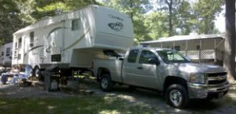

Posted Image
2009 Silverado 2500HD ~ 6.0 ~ 3.73's
Prodigy Primus IQ Brake Controller
Reese 15k Pro-Series Fifth Wheel Hitch
Rhino Linings Tuff-Grip Spray In Bedline
r
Towing Questions? >> http://www.gm-trucks...howtopic=124008 <<
