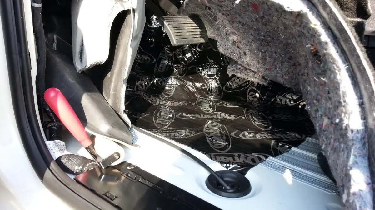

I installed Dynamat Xtreme and Dynapad in the driver's floorboard, it didn't help, just a waste of time and money.
