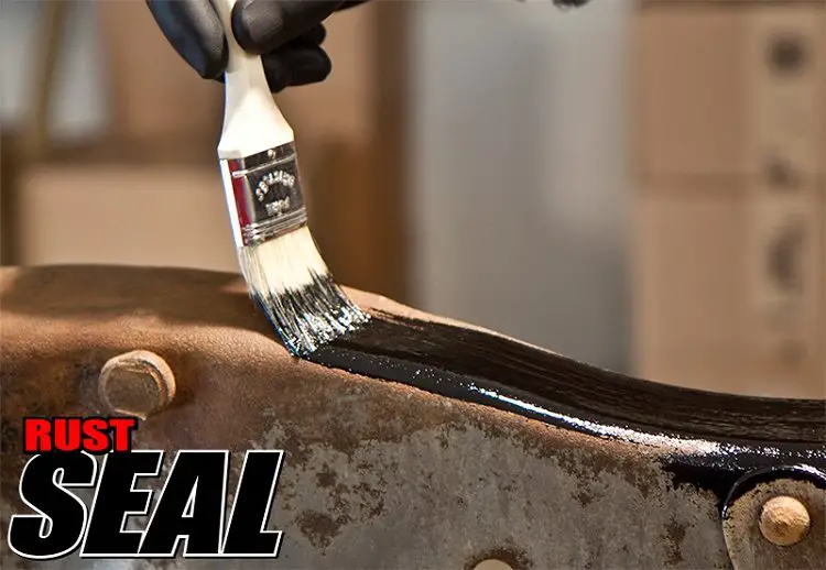

If the undercarriage is surface rusted, is there anything you can spray overtop to stop it from further rusting more? Like spray paint or rhino lining or something similar? Or are you required to sand it all down to bare metal before spraying over top?
No there is not. Anything you sprayed on top of the rust would flake off or rust off. You would need to sand down and get all the rust off of there first. And even then there are no guarantees.
Chassis Saver or POR15.

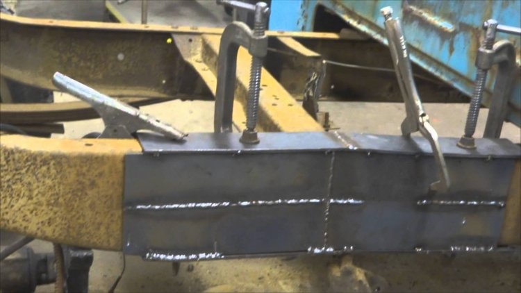

Any repair shop that sells cars will tell you that its not fixable, regardless of how bad the rust is. They say this to get your truck for practically free as a low value trade in, PLUS they get to sell you another vehicle. What exactly is the problem with the frame? If you hit the frame with a hammer, does it punch a hole it it? Did the truck break in half? Or is it just rusty?
Unless the truck is literally falling apart, you can easily fix it.
Applying a rust inhibitor to the frame will immediately stop all the rust.
Don't throw away your truck just because one repair shop said it was junk. Get a second opinion, and then go to a metal fabricator or welding shop and ask them to try a repair. $250 worth of welding can go a long way.
