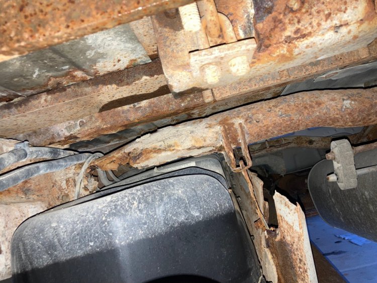

I've got a similar problem with my 2003 2500 4WD Suburban. I've had numerous issues with it - all I believe related to rust. I've had to replace brake lines, the rear bumper is rusted out - the frame is really rusty - etc.

My 2006 was pretty bad at 230k. Mainly just surface rust, not to much came off in chunks.

I am not impressed with the "look" of my frame. i have an annual rust check service done and have a full warranty with them. the wax was peeling starting in 2012. i used to spray rust check black paint to help keep it protected. i had installed in the fall of 2013 a gm wheel well protector. we have bad witness here, but my truck gets rinsed off daily. that is right daily. i also gets hand washed several times a week. still when i am under neath, i have concerns with keeping this truck long term. but it is what it is. in fact i figure i wash it so much, that i have caused my dash board to crack!!!!! :)

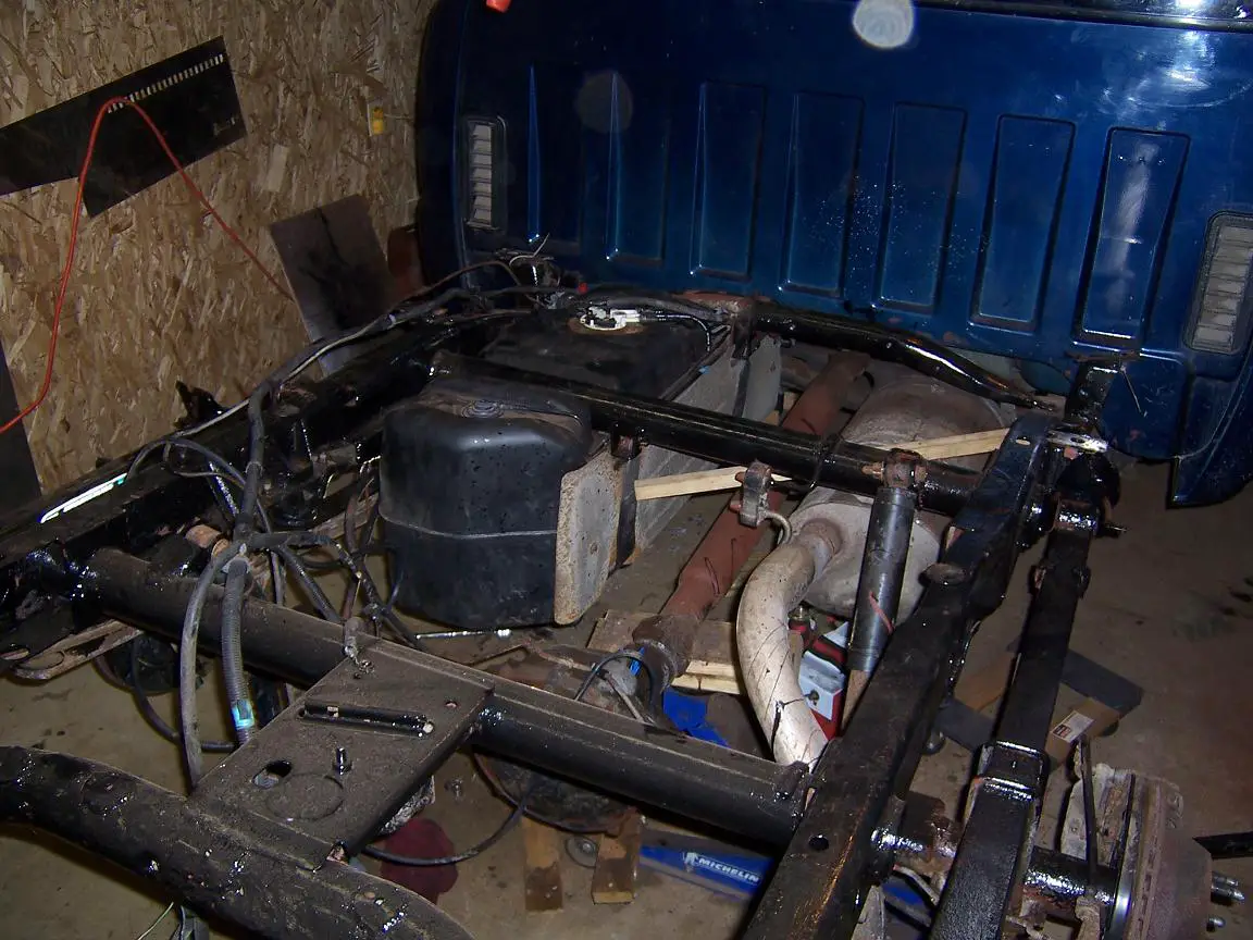

I noticed the replacement cross member tube is straight tubing versus the obvious curve in the factory tube. Doesn't the straight tube cause the gas tank to sit down in back at an angle? I am just preparing to do the same repair to my 1999 Silverado and it would sure be a lot simpler to use a straight tube instead of fabricating one with a curve.
MichaelJT
Good eye...The tank is unnoticeably lower, You would literally have to measure it to tell a difference. But that being said where you will notice a difference is with your gas tank strap bolt. I used a threaded rod and a nut instead to make it easier. If you want I can take a picture of it all back together so you can see how it looks.
Thanks for the reply. I figured it would have to be that way. What is it about the straight tube that necessitates the threaded rod and nut?
I used threaded rod and a nut to attach tank strap in my former 2000 Silverado but that was just because the spring nut broke and I had to drill it out. I made my own T-nut for the top out of steel bar stock. A matter of using what i had on hand.
I have my 1999 apart now and and I am beginning the repairs to the rusted portions of the crossmembers. There is very little detailed documentation on the web for this particular repair and yours is among the best.
Please post the picture here as I am sure it would benefit others besides me.
Thanks!
MichaelJT

Well, I know why you needed the threaded rod and nut. The strap is actually too short to reach the bracket. I fixed it by modifying the strap to be longer there and that fixed it. The strap had already been cobbled together because of rust by the previous owner and i just cut out that shoddy work and made it the correct length. Lots of work replacing all those cross members and gussets but very satisfying. I'm ready for another 16 years now.
