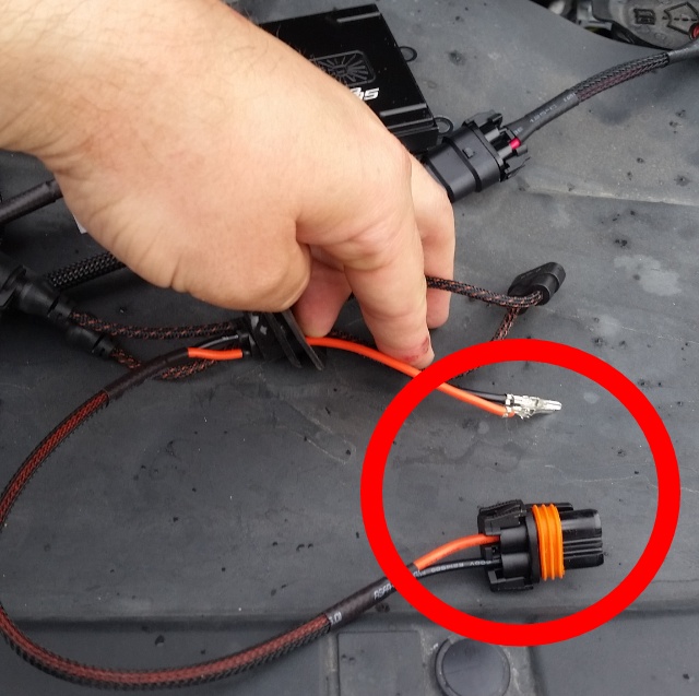

What am I missing here....Attempting to hook the kit up for my 2014 Silverado from lightwerks I got the Silverado Spec kit and maybe my brain just isn't firing on all cylinders today but I can't figure out if this is an am extra connection I can get rid of or not? As of right now I've got it going:
Stock output-> capacitor link-> hd relay-> ballast-> igniter-> bulb
Haven't fired it up yet cuz I wanna be sure of this connection in the picture first. Also, the capacitor link won't plug into the stock output with the connector attached. Had to remove it and just plug in each blade of the connector.post-165009-0-10318100-1499718590_thumb.jpg
