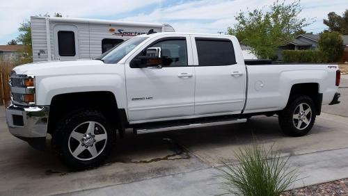

Leveled wheel setup
This is the only one I have right now of a wide shot. The next day of full sunshine that I have off work, I'll take more.

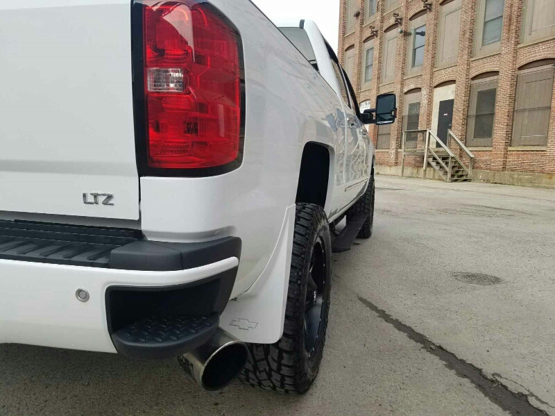

I went with 305/60/18's on Fuel rims with a +20 offset and there is no rubbing at all. I know the original post was for 20's, sorry if this doesn't help. Just another option for ya.post-155499-0-43861800-1459694394_thumb.jpeg

I went with 305/60/18's on Fuel rims with a +20 offset and there is no rubbing at all. I know the original post was for 20's, sorry if this doesn't help. Just another option for ya.attachicon.gifimage.jpeg
That looks sweet!

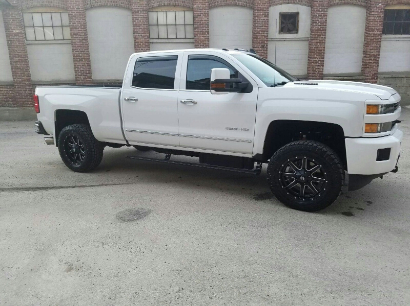

I went with 305/60/18's on Fuel rims with a +20 offset and there is no rubbing at all. I know the original post was for 20's, sorry if this doesn't help. Just another option for ya. image.jpeg
Did you say you were leveled? If so did you use a kit? How high did you go? Looks great btw.
That looks sweet!
That looks sweet!
Thanks!
Yes I did use a level kit. It was the Rough Country 2.5 torsion key kit. Thanks!

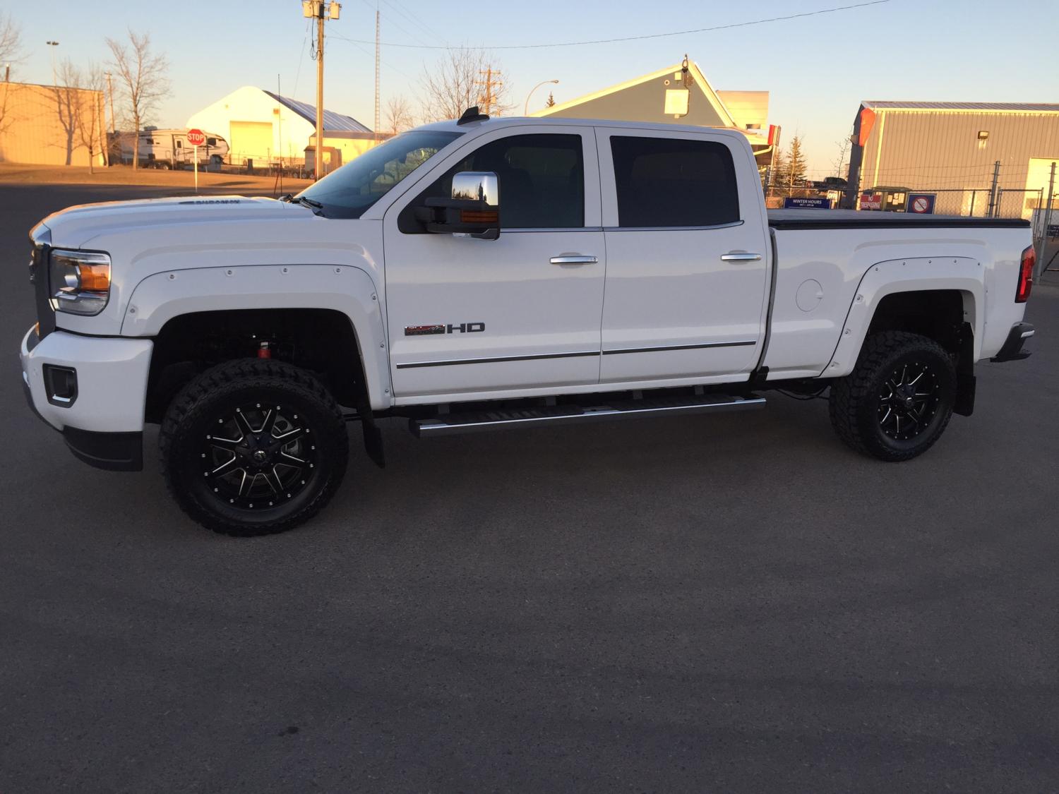

Just upgraded from 245/75r17 to 275/65r20. No rub, no trimming needed.
Truck looks amazing! Love the setup, and can I ask how you like the 6.0?
Are you running a leveling kit?  I just bought a 15 2500 and the tires look stupid on it!
