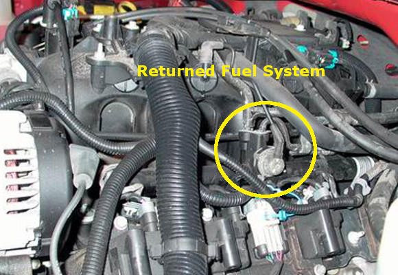

I was told when I bought my truck that the fuel pressure regulator is bad. What are the symptoms of it going bad?

If I recall it was '03 when GM switched to an in tank regulator so I'm not sure how to test other then hooking up a gauge. However, if the regulator is still on the top, driver side of your engine, see my last post.

My regulator is on top of the motor. I will give it a shot when I change the plugs out. Should the motor be running or not?
Really easy then, pull that hose off the top of the regulator and see if you there is any fuel in the hose. If there is fuel, you need to replace the regulator. Sometime I will have to remember to check mine.

ok should the engine be running, warm, cold or off?

04 is when a returnless system was implemented and removed the on rail regulator

:thumbs: Gotcha, thanks. I knew it was in that time frame somewhere.
