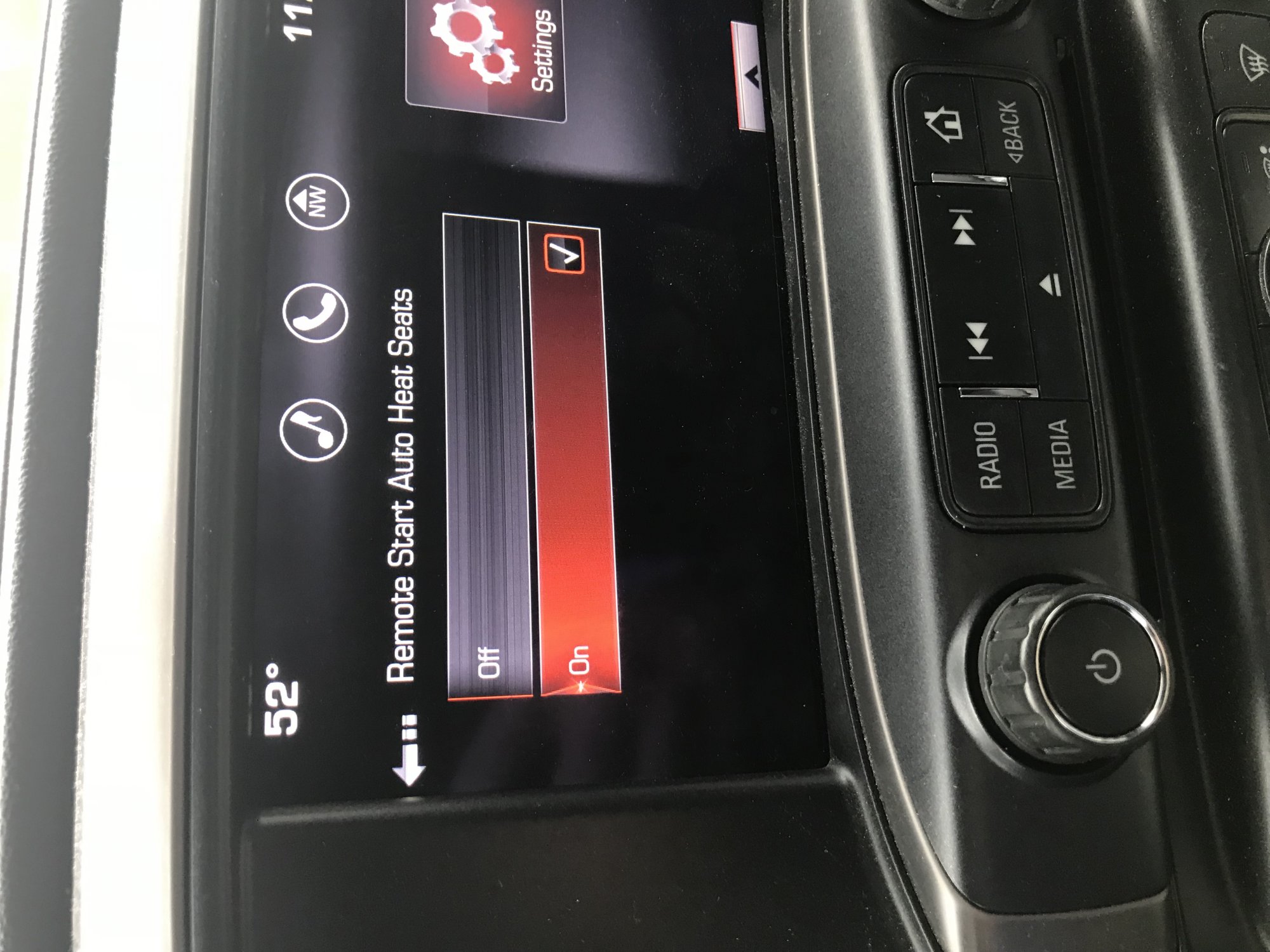

3 hours ago, truckguy82 said:
how'd you do that? I also have a '14
3 hours ago, DDogg said:
Agreed- I also have a 14 and would love to have the seats on when it is auto started!
using the dash touch screen....
- settings
- vehicle
- remote lock, unlock, start
- remote start auto heat seats
- ON!!!
- settings
- vehicle
- ON!!!
Thank you!

My heated seats dont get as warm with remote start, sometimes i question if they even are on. Each remote start session is 10 mins. You will have to re-start every 10 mins if needed.
One thing i figured out is, whatever settings you leave your heat selection on when turning the truck off is what you get with remote start. So before i shut it off i do windshield mode, heat to high and fan to high. After 10 mins the inside is burning hot :)
