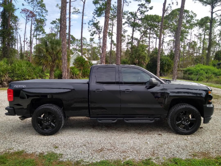

5100's working well so far... good ride no rub and no big drop in mpg's.
Added bed cover a few weeks back to keep cargo dry.

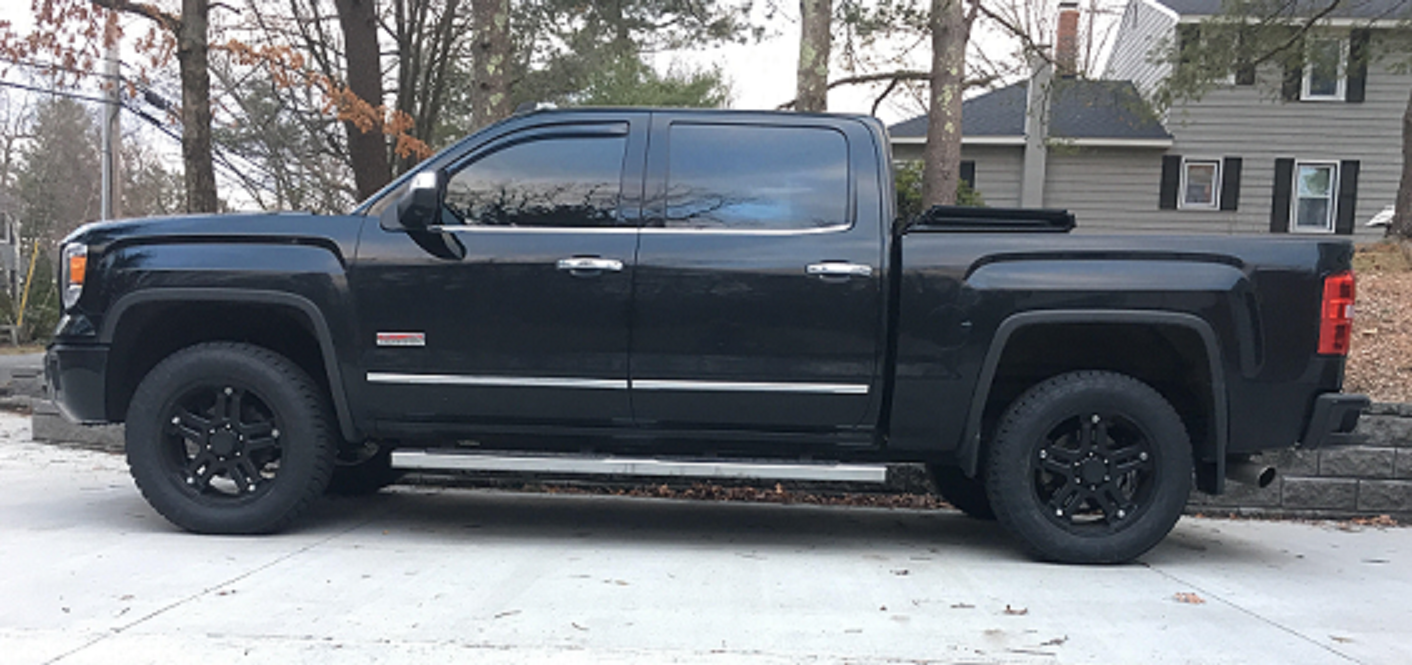

FWIW I have Bilstein 5100's all 4 corners top setting in front w/ 33" 275/60R20 Nitto Terra Grapplers + 2.25" (+1") rear blocks. My total before/after ride height for the front was a hair over 2.5"....so either the bilsteins @ top setting are really more like 2" or the tires are a little taller or combo of both. I run 44 psi front 42 rear.
I had 2200 lbs of rocks in the bed w/ this setup & it did not appear nose high, it still looked level - that isn't apples to apples to towing a trailer, but I think if you're not maxing it out you'll still have a level ride height may even maintain some rake depending on tongue weight.
Here are some pics w/ this setup (no weight in the bed though) - its tough to really see the amount of clearance added w/ the thick stock running boards, but its significant & really is the perfect stance for this generation of GM 1/2 tons IMO. I removed the front chin spoiler/air dam/diffuser (whatever you wanna call it) & that really added to the "lifted" look of the trucks stance, also improved overall clearance, I noticed MAYBE 1/2 mpg difference on the highway, although that could also be attributed to the height increase in general.
Actually, I think running 275/65R20's would be the PERFECT look/height, except you can't get a non-LT 8+ply AT tire in that size & I didn't like the drop in acceleration/braking/MPG performance w/ the heavier LT tires so decided to stick w/ the 275/60R20 Nittos.
Lastly - 2 pieces of advice, #1 if you get these shocks I'd hit em up w/ some spray can clear coat before installing so they stay nice looking, they have stainless steel body but is 400 series & will oxidize in salty road conditions. #2 - if I were to do it all over again I would look into Eibach's setup as well - they are American made quality shocks & they offer a similar adjustable gas charged shock but also offer it w/ matching front springs (for a lil more $$$). I am satisfied w/ the Bilsteins though & will probably replace them w/ the same model once they're worn out - I have over 50k miles on them so far though & still ride like they did when new.
