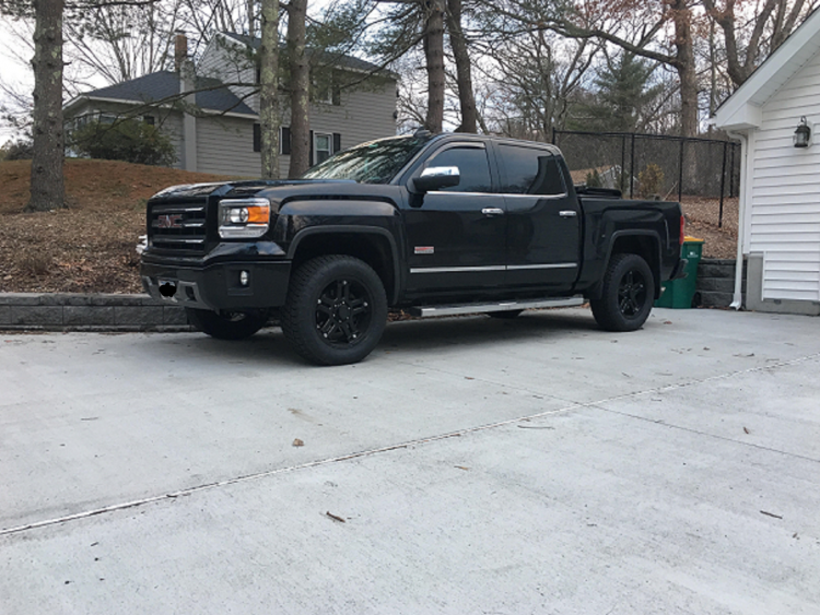

5 hours ago, DeuceDeuce said:
Thanks to all the advice on this forum I leveled my 2016 with the 5100s. Tires are 275 60 20. Happy with the way it looks compared to stock.
3rd or 4th setting?

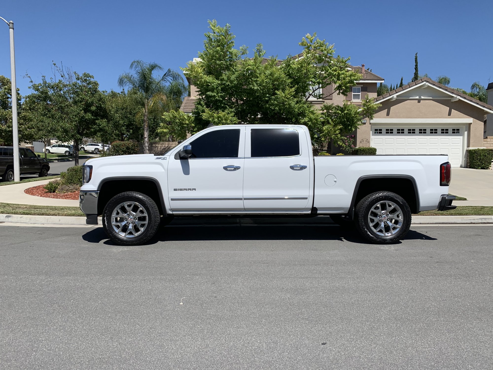

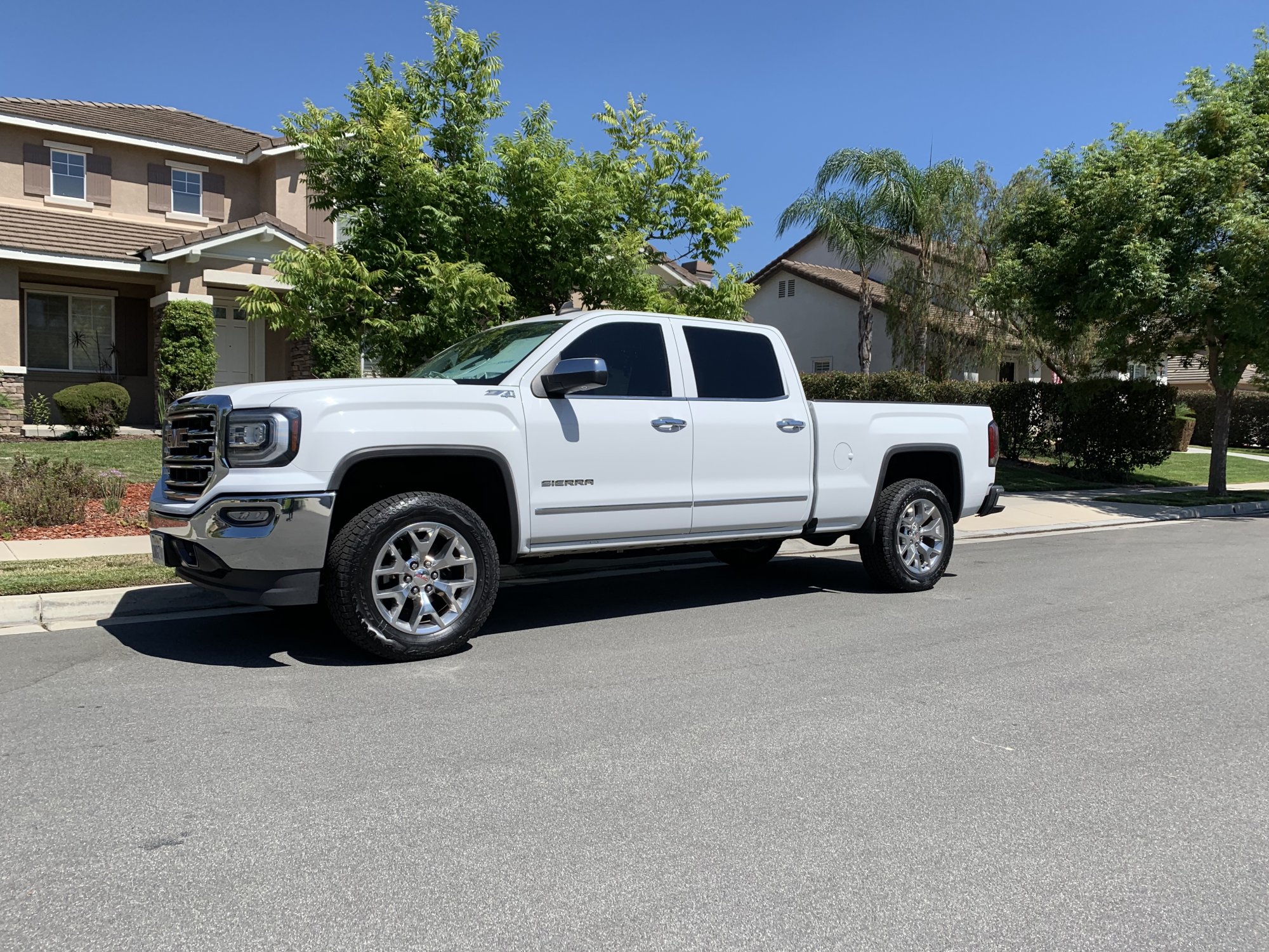

I have the 2018 model but used a Rugged Off Road spacer on the 5100 front struts and have no rubbing at full lock on either side.
5 hours ago, Silva said:
I remember reading on here that after leveling, a 275/60/20 tire on stock wheels would rub. I know that the tire doesn't rub on stock height. Do you know if your set up rubs anywhere? Not sure if this is true or not maybe someone can help.
Absolutely no rubbing.
