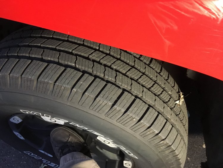

I took it to a certified Goodyear dealer today and he said they were all terrain tires and designed for the road. You will be able to see this is true from the pictures that I am about to post. They look more like "highway" tires than the previous ones I had from the link provided. So my door recommends that I run 35 PSI in the tires and right now they have around 40 PSI if I am not mistaken. That might have a lot to do with it. However, my tire pressure sensors are already telling me to check them and believe that they are probably have at least 37 PSI in them. The following link I found will show you what they are.

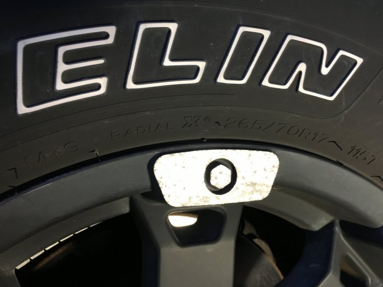

Yeah that is what I thought and still sort of think. When I took them out to the Good Year shop he said they were not LT tires. He said if they were true LT tires it would be before that first number which is 265 on my truck. The last tires were P265/17R70 there are 265/17R70 and the LT is written somewhere else. He said that means they are not true LT tires, not sure if he knew what he was talking about or not.
However, he said the same thing you just did, that there was a great deal more rubber in the sidewall of LT tires. He said he is 100% sure mine are mostly highway tires and he is pretty much right. You can look at them and see that there is nothing on the sidewall for griping snow/mud. Then if you look at the pattern you can clearly see that it is a highway pattern. When I bought them I was told they were manufactured with towing and payload in mind. However, I would not lose ride quality. I thought both of these are true, but only one is.
