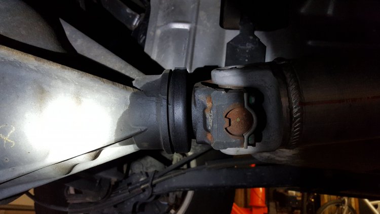

I purchased a used 2019 Yukon with 34,455 miles on it currently.  While doing basic pre-winter maintenance I did notice that the rear differential housing was damp around the pinion.  I thought this was unusual for the age and relatively low mileage, as there are no oil leaks anywhere else that I could see crawling around underneath.
With that being said it doesn't necessarily look like a fresh leak.  Just damp.  I cleaned it with brake cleaner and will keep an eye on it, as my bumper-to-bumper warranty will expire at 36,009 miles.

Looks like a leak to me, i would set an appointment and get it taken care of, no need to keep an eye on a part that is clearly not right.
Gm will have no trouble declining to fix it if you wait too long, i wouldn't chance a seal being replaced with the PT warranty at no cost.
