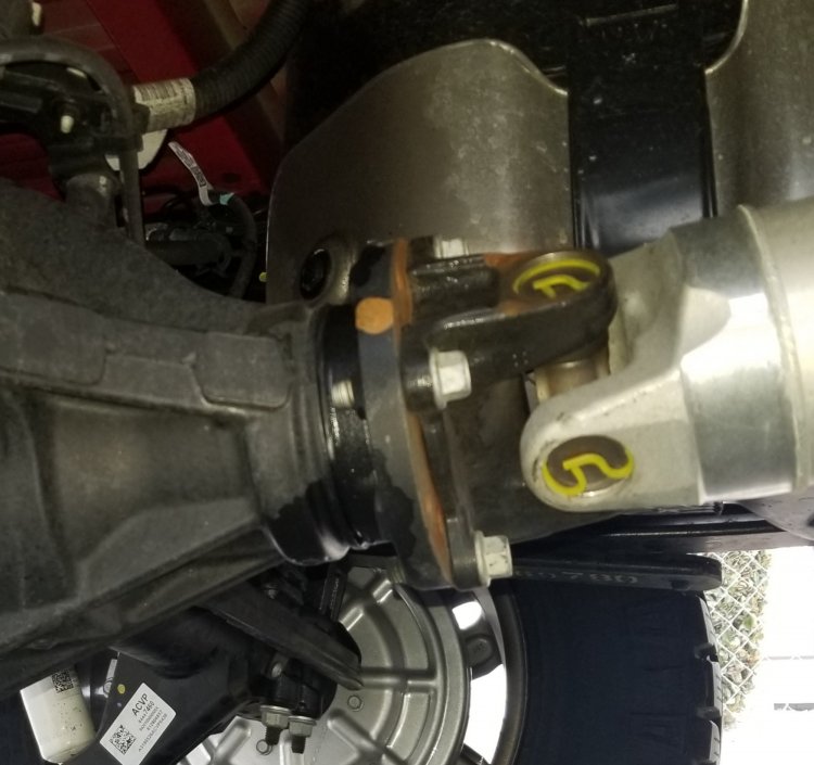

On ‎1‎/‎21‎/‎2019 at 3:55 PM, DougFL said:
Thanks for the suggestions.  The rear was replaced today and Everything seems fine.  No clunks or vibrations and Truck drives smooth.  Photo below is old Rear with 10K miles on it.  You will notice the oil stained area around the pinion where the oil was being slung from the leak!
This picture is of your old assembly at only 10k miles? Sheesh, looks like it has endures several winters and or is 5-6 years old.
Not a very good coating or painting job from the factory on T1 if you ask me. Look at all the surface rust/corrosion already starting to form.
Agreed, and I just now noticed its a 2019....good Lord I need to see my eye doctor :cool:  Well, visit him because it's pretty obvious I can't see...
Agree and the 10K miles was in Florida with no salt or winter conditions, but plenty of rain!
It's called rust browning, a natural protectant!
Sounds like the seal arrived at the dealership today, bringing the truck in to have it repaired tomorrow.
Update: the brilliant service manager didn't order the nut, he just ordered the seal. So after bringing the truck in, they discovered they needed the nut too. After waiting 9 days, it's finally fixed.
Wow!  Have you been mud boggin out in the swamps with your truck? I have a 2016 up in the salty rust belt that aint that dirty looking.
Nope, no salt, no swamps, just Florida rain!
