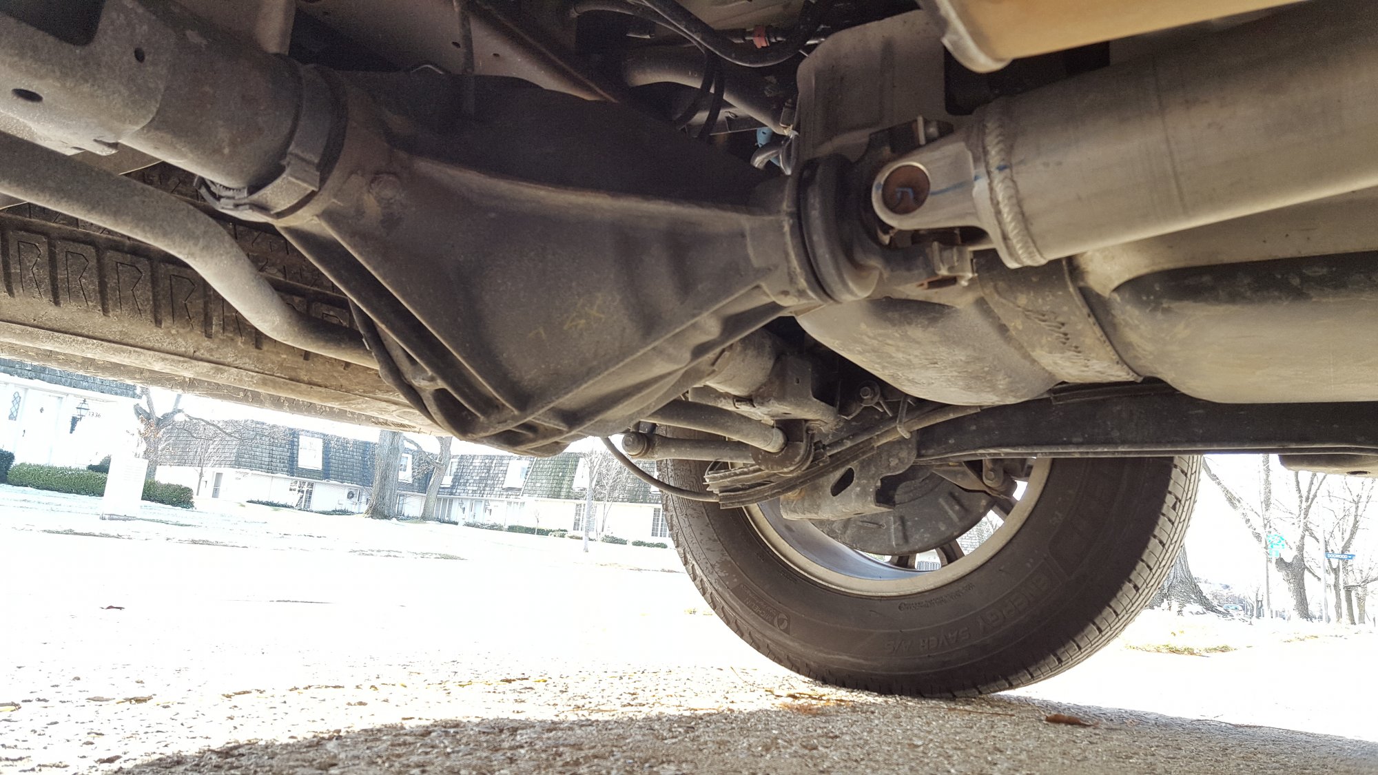

Nonetheless, I posed the picture of my rear differential the other day showing some oily residue near the pinion.  Shortly after, I cleaned off the housing with about 3/4 can of brake cleaner.  I was surprised to see that it hasn't seeped since.  As I said it didn't appear that the oil on my housing was necessarily fresh.  I also removed the fill plug on the cover and the oil level was just slightly below the hole, so it's still just about entirely full for certain.  Who knows what's up.  I'm going in for the recall this Friday but I guess I won't be able to mention it since the housing is dry.  If it stays dry I won't be concerned about it in all honesty.  I still have about 1,500 miles remaining on the 36,000 mile bumper-to-bumper warranty so there is plenty of time to see if the seepage will return or not.

Strange thing, it has been a few hundred miles since I showed that picture of my rear end.  I cleaned it with a full can of brake cleaner and haven't seen anything since.  Is it possible that the seal needed to "wear in" to the brand new pinion upon assembly?  From what it looked like, it was not a fresh spray but rather old oily residue.  The differential is full of fluid as well.  I'm not accustomed to things that only leak "sometimes" but that appears to be the case here.  I can also understand an imperfect sealing surface OR seal itself that eventually wear together after some time.

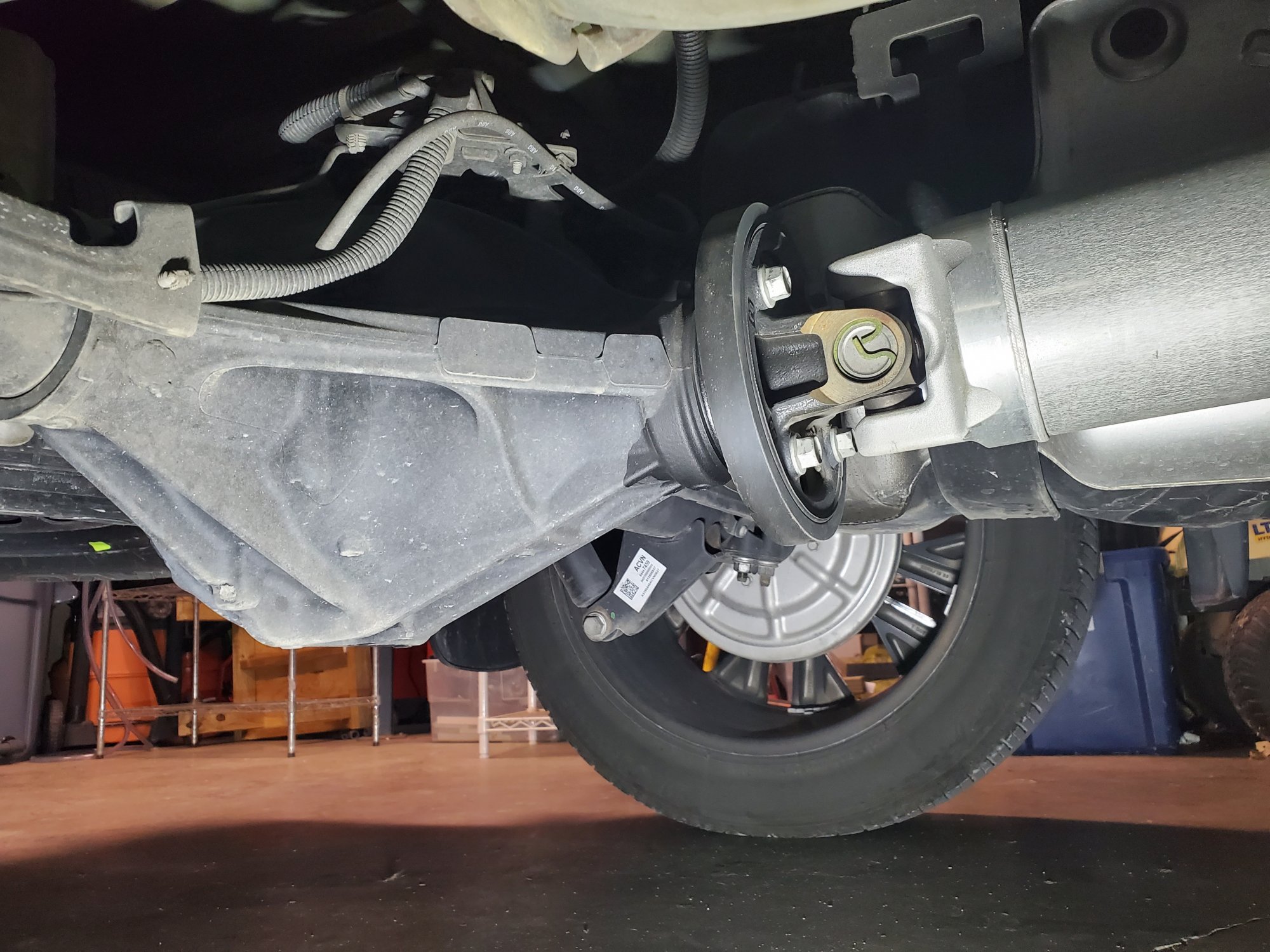

Found that mine is leaking this week. Taking it in Monday to get a loaner and have it fixed. Assuming they will just do the seal on mine as well. Have splatter on the exhaust, bottom of the bed, and the fuel tank. Could easily be wiped off with some degreaser but am leaving it until it's fixed.
Sorry to hear. Same exact experience as well. I didn't bother to take a look at the part before it was repaired but seeing your picture now. They replaced the whole yoke assembly to fix the leak on mine. Didn't realize the original was painted / coated as pictured, mine is bare steel and already taking on a rusty patina. Oh well, Interested to see how they tackle your repair. Best of luck!
