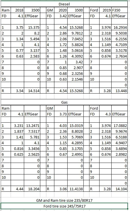

Unless my math is bad or I mistyped, the overall gear ratios are very similar to the 2018 Ram 3500s...Hence the "highway" rear gear shouldn't be a big deal (gas reverse being the exception); plus it means you end up with a beefier pinion gear.
(Also assumes my Ram data sources were accurate.

From what I can see they both use a 235/80R17, so stock to stock that still stands.  But I am curious how you mean that exactly; if I put 40" boggers on both trucks that doesn't change the effective gear ratio at the hub.
Interestingly, if you load the 4.10 rear from the Ram in the Chevy diesel on that spreadsheet, the top gear overall is the same with first dropping to 18.6:1.
Rams poor performance with the 6.4 Hemi has been blamed on poor axle ratios / gear ratios in the transmission.  Power-wise the new truck should perform like the old one that had 4.10 gears.  Had GM gone with the 10 speed in the gas engine they would have no reason for 410 gears, 373 would be perfect in my opinion, even 3.42s would be great for someone who wasn't towing but needed the payload

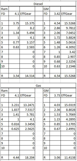

Your chart also proves that while Rams first gear isn't as aggressive, there's tighter spacing between gears which is ideal for towing.
I don't understand the reason not to have the ten speed on the gasser either (in the small trucks the gasser has and 8 and the diesel has a 6 speed).  My main reason for my initial post was that I think people get to caught up in the asle ratios without looking at what may have changed in the transmission ratios, and I was attempting to show that another HD truck line was similar in the overall drivetrain ratio.
