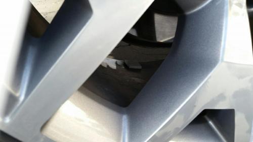

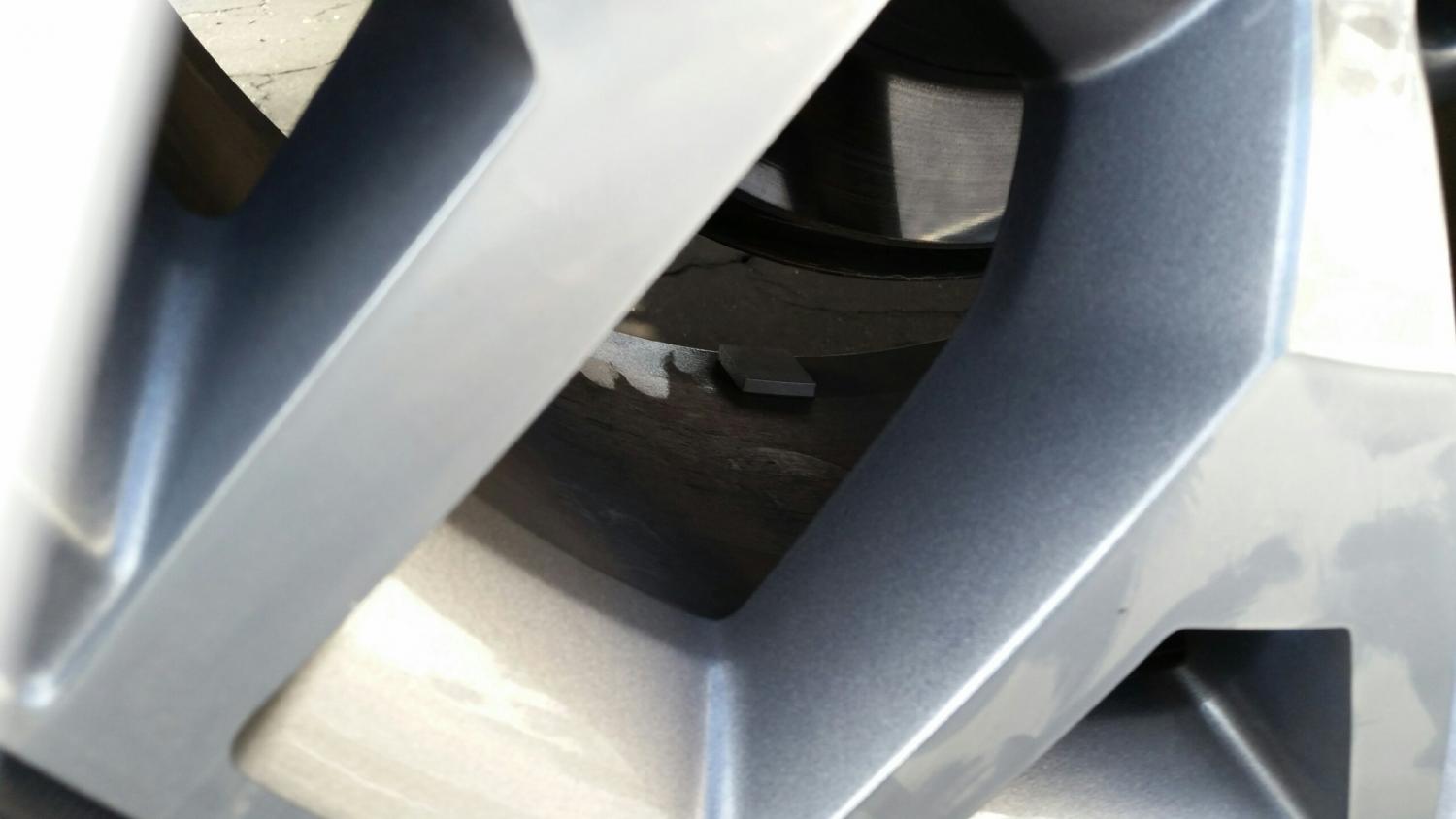

the infamous right front wheel/tire with DEALER applied weights and tech installed scar. there are weights all over inside of that wheel btw, different locations... that's just to show that dealer actually did replace factory weights.

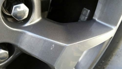

left rear wheel center cap with nick on it since delivery (haven't bothered mentioning, just wanted to show as quality control is definitely part of the problem here imo.. why not just pop that cap off and replace before it leaves factory or dealer prep/tech inspection etc?? idk who is at fault, factory or dealer but regardless, subpar imo)
