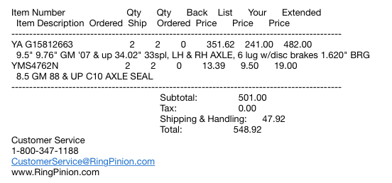

Here's the shipping confirmation I got.

I ordered my Yukon gears, posi and install kit from East Coast Gear Supply, great people to deal with. I'll probably be ordering axles from them soon after hearing this. Edited by Darth_Vader
