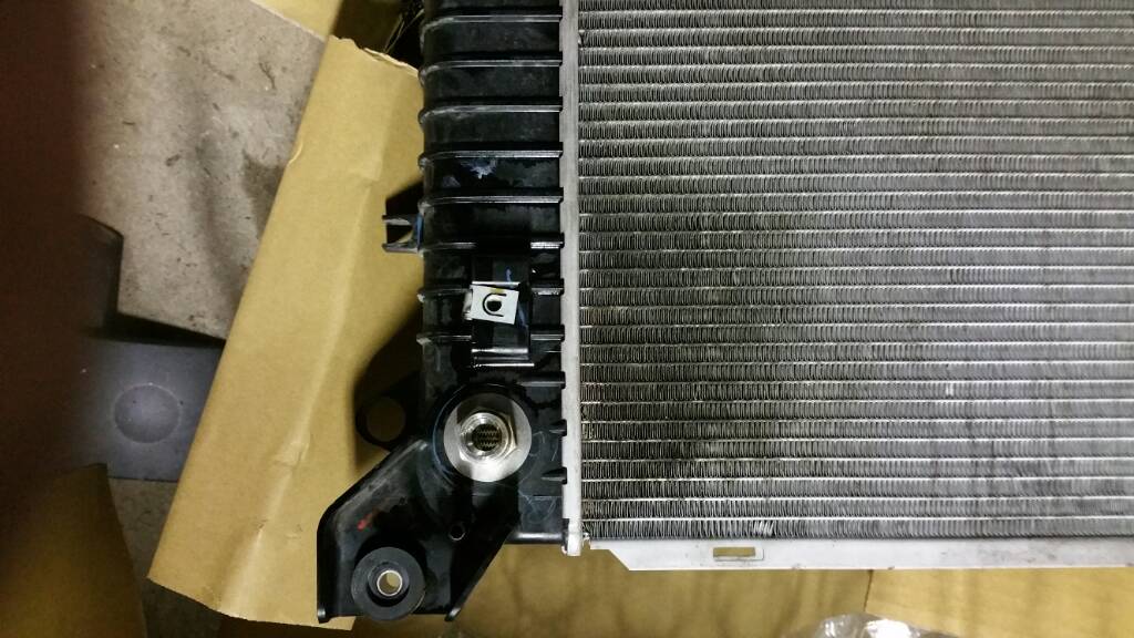

I had a slight smell in cab but could smell it worse after I got out of the truck. I just bought this truck had 55000 miles on it I have only put 4000 in 4 months. So I called the dealer where I bought it they said bring it in. So I drive 1.5 hrs one way they look at it an hour later they say radiator is seeping. Then they proceeded to tell me it was going to be 1000.00 to replace radiator and thermostat since my truck was out of the 3/36 warranty.
This is a load of crap they showed me where it was seeping and clearly it has been doing this before I bought it. I think they are trying to get money out of me on something they should have fixed before they sold it. So I contacted another dealer closer to me and they tell me that it is a know problem on the 14 and some 15 Silverado's and there is a new designed thermostat that helps to regulate press so it doesn't happen again.
So I asked them if there was anything that they could do which there wasn't. If this is a known problem on the Silverado then GM should fix it. It is ridiculous that a truck with less than 60000 miles that the radiator is leaking. So I called GM and they say there are no problems with the trucks (ok) I said we'll then you should look at all the complaints on the radiators and heater cores that have been replaced. I think this will be my last GM product I have owned them for 25 yrs but the quality control sucks. Here is a pic of the radiator post-155704-14578282173_thumb.jpgpost-155704-145782824385_thumb.jpg
