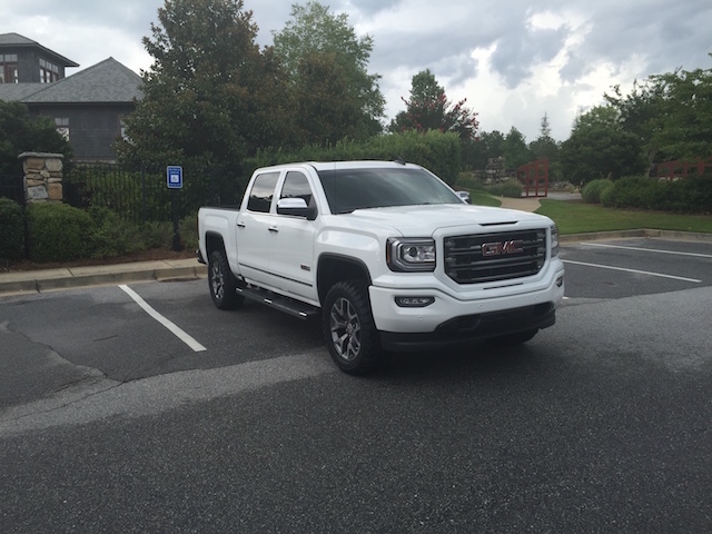

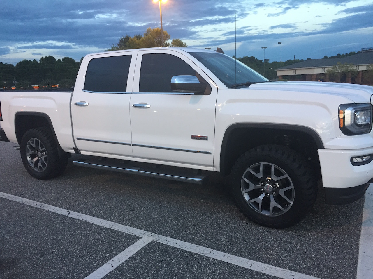

Hey guys, picked up my truck about 2 months ago and have been doing a few things to it. First thing I did was remove the boards, tint and added the Z71 emblems. I've also added a 2.5" RC Level and 33x12.50r20 Toyo MT. Lovin' it so far.
Couple pics:
Beauty! Is that the short box bed or standard box? Great looking truck
Looks sharp!
Thanks so much!!! My first 2 vehicles were pickups but have spent the past few years in Wranglers and a 4Runner. It feels so good to be back in a truck!!!

Looks amazing man. Wanting my '16 to look like this. How are the ball joints and everything holding up? what about ride quality? seems like everyone says 2 - 2.5 in the front is the sweet spot. Looks damn good to me.
Couple pics:
