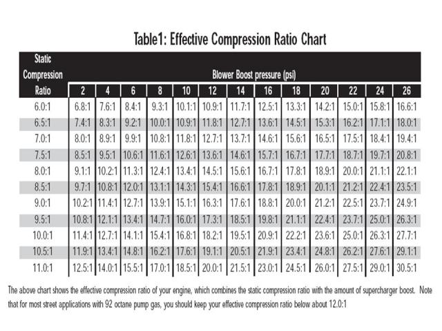

post-142991-0-96690600-1450249706_thumb.jpgSo I have a question. I have researched the static compression ratio for the L83 EcoTec3 to be 11.0:1. the chart above is showing us what our effective compression ratio (boost PSI + static compression) will be after the fact. Lets say that I choose a Whipple, and it produces anywhere from 6-8 PSI of boost. That now puts us at a 15.5-17.0:1 effective compression ratio. From what I have read on the internet thus far is that a static + boost compression ratio over 12.0:1 will make you very liable to detonation. However, we have many people who have done this already without any issues(that we know of). obviously a tune would change the way the engines act to the supercharger, right? So my question! what is our maximum effective compression ratio before we start seeing problems ON A STOCK ENGINE? is it 12.0:1? or is there someone here who knows there stuff and explain it to me and maybe others in an understandable context? Let's talk Superchargers.
Static and Dynamic compression are two different animals. Dynamic is the cylinder pressure (PSI) at the time of the intake closing events of the camshaft. Also the cylinder head design plays a big part in the situation too especially the chamber shape to keep detonation at bay. Don't get to caught up on Static numbers. Also DI engines curb detonation a little better than other forms of fuel injection to. For instance I have a Harley Davidson with a 120" motor with 13.5:1 and it has 220 PSI cylinder in both cylinders and has two sets of compression releases to help turn the engine over during start up and runs fine on pump gas but it's all in the tune, I have a powervision tuner with 3 tunes i can switch to 1. for 87 octane 2. for 93 octane and 3. C116 race fuel.
RT
Direct injection is the key here with boost. Take the Ecobust Fords... the 3.5 is a 10:1 static engine that runs 15+ psi stock and rated for 87 octane fuel in the trucks. When the fuel isn't in the cylinder to detonate it makes it harder to do so.
Sent from my SM-G900W8 using Tapatalk
Look also at the Lysholm kits. Less $ and still the same Eaton TVS blower. I like Magnuson as the intercooler brick design seems to do a great job.
With any of these you will want to do the proper effective catchcan system like the Elite new E2-X system w/cleanside separator as 1994Vmax states, you do not want any combustible present during the compression stroke or detonation will rear it's ugly head even more severe than old port injection.
Also do not want that oil to bake onto the intercooler and insulate and obstruct the flow over time. This is after 14k miles:
Also would add the ecoboost Ford makes more power and gets better fuel economy on 93 octane as the KR is so much less and it can run more advance timing.
Throwing out a lot of phrases I'm not familiar with, so to the internet I go! Thanks for the explanation, however. There is just too much I don't understand right now.
