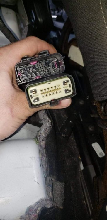

So I just got a 2015 Police Tahoe that wasn't originally equipped with any center console.  The previous owner had a jump seat installed but never hooked power up.  I one to find out that the harnesses are mismatched...the truck has the 23pin, the jumpseat has the 16pin...
GM used 2 different types for jump seat connectors for 2014 and some 2015 trucks.  Some time, mid year 2015, GM switched to 16-pin.  So the jump seat that was installed is a midyear 2015 and later while the original jump seat was from 14-early 15.
You'll want to see if you can find a jump seat harness for 14-early 15 and swap it out.
