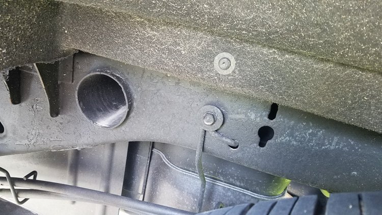

I recently took my ride in to have a good once over before my 36 month warranty expired. No real issues with the truck at all. My frame had rust on it, but I didn't think it was that excessive for living in WI. But I asked about it when I was there. To my shock, they volunteered to repair the rust spots and re-coat it under warranty.
Here's some before photos of my frame:
same location, after the repairs:

I think the problem is that the stuff just comes off too easily and then the rust gets in and spreads underneath it. I have a 2018 and the thing showed some surface rust as soon as I brought it home...on the bed tubes, on top of the front spring mounts, at four spots where a tech put the thing up in the air on a lift, at various crevices.
I patched some of the bare spots with a rubberized undercoating, on others I used fluid film, and on some others I stripped the coating off, sanded it down and painted it with POR. I feel like it's something that unfortunately I have to keep up with weekly or else it'll get out of control (and it's not even winter yet, this is our dry season).
I'm planning on doing two things...I plan on buying some Nox Rust for touch ups, and I plan on doing an undercoating treatment twice a year with either fluid film or NH Oil undercoating.
I know its just "surface rust", it's not the end of the world...might not ever be a serious issue, but I don't want to chance it. I've seen three 2014's that have frames that look so corroded you'd think they were 20 year old trucks (one of them doesn't appear to have any wax coating left on the thing).
