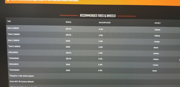

You need different rims/tires or some trimming.  There are 4 sizes listed on the Fabtech site for this lift.  Although it's not marked, the Trailboss is the one that fits the 35x12.5, the 295 width tire is for the AT4.  The wheel wells are smaller as I mentioned earlier.  The Fabtech kit also has a 5" backspacing which your 22x10 doesnt have.  The Rough Country kit accepts your rims offset but not this kit so in reality the best option for those looking to lift the Trailboss/AT4 is the Rough Country kit not the Fabtech one.
Fabtech:
Rough Country:
