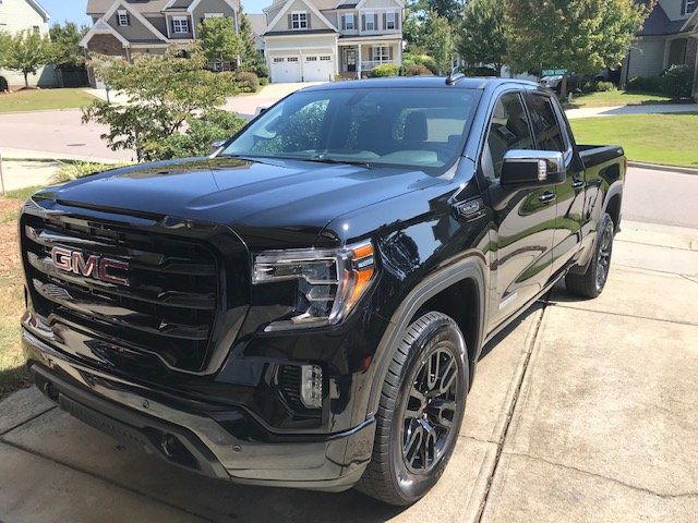

2019 Sierra 4x4 Elevation - $1,500 DIY Budget Build
Just getting final pieces of equipment pulled together for my upgrade to stock base 8" screen system. Goal is to keep total price around $1,500 (Ebay/Amazon). System will consist of Hertz MPK front stage and  CPK rear fill, Rockford Prime amps, and 2 10" JL subs. Looking for more SQ than SPL. Plan is to sound deaden doors for best SQ from Hertz MPK & CPK 6.5". I will build a custom up firing under sealed under seat enclosure for 2 JL 10W0V3 and incorporate an amp rack. Will post some progress pics as things get installed.
