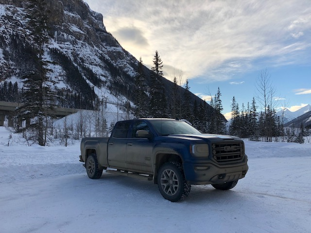

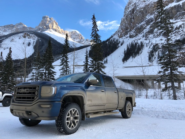

I have a 2016 GMC All Terrain (same 20" wheels but not chrome) I have the 2.5" Motofab spacer up front. I'm running BFG KO2's 275/60/20 It has a slight rub at full lock, it's barely rubbing the paint off of the UCA. It's not a problem for me, but I wouldn't want to run anything wider with the current setup. I have a crew cab with the standard box which can be challenging to maneuver in tight parking lots already, and wouldn't want to limit the steering. You can fix it with wheel spacers or different offset wheels, but you can also cause rubbing on the bumper or back of wheel well. Good luck with your setup and let us know what you come up with.  image.png.7634b2384670abea9bc94358f9eb5be0.pngimage.png.5de3ad26631c3daf628343d961e4628f.png

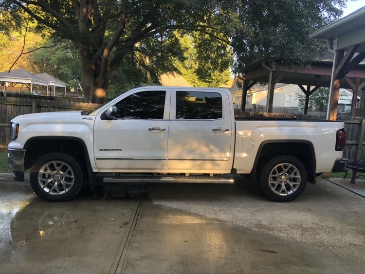

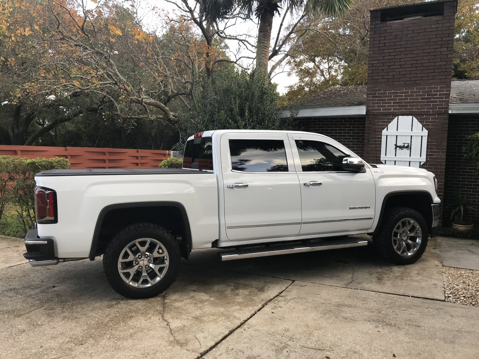

2.25” Leveled
4.5” CST Lift
